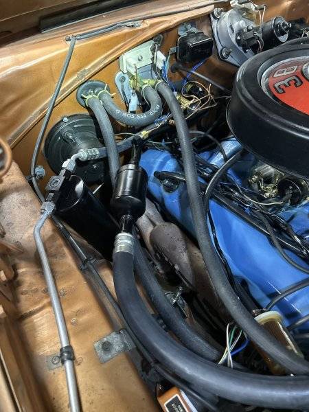

PS: I looked back at your pics. You do have a RV-2 compressor, and it looks like you are probably using the port on the cyl head. I looked at my manuals to refresh my memory. 69 Charger should have an EPR valve in the suction fitting at the rear of the compressor. The should be a gauge connection at the fitting at the back of the compressor. The is where you should hook up a gauge to check suction (low) side pressure. If you use the gauge port on the cyl head and the system is low on charge you will get the results you are getting. In normal operation pressure at the fitting on the rear of the compressor will generally be higher than the fitting on the head.
Can you post a picture of the expansion valve and how/where the small copper lines are connected? I can't make it out on the pic you posted.
