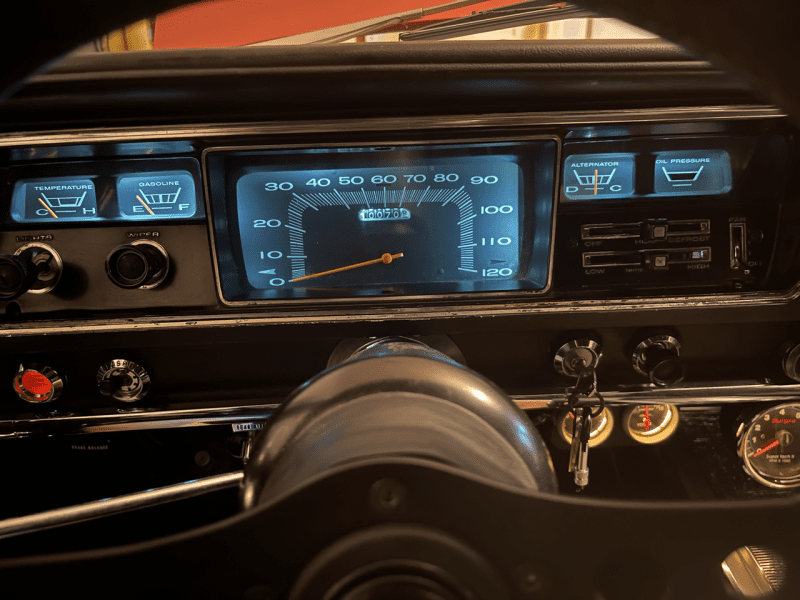

OK, I replaced two of my instrument bulbs, did some wiring repairs and found that I have instrument lights! But only in one sweet spot when turning the know so I think a new headlight switch will give me full control.
Now only lights that don't work are the tach light and the console shift indicator light so I am pretty sure I can get those going soon. Many thanks to all your advice and suggestions.
^^This. The LED upgrade just brings the old dash to life, especially at night. I bought my LED's from Amazon, think it was $8 for the pack, and they work perfectly.
I also did the LED Dash Light Upgrade, what a huge difference !!
It was a frustrating task, but I took my time with a few beers, figured it out and it was well worth it.
Perfect dash lights now.
Got the bulbs from Amazon, pretty cheap upgrade.
I switched the flasher module to an LED compatible unit, and I have no problems with blinkers or E-Flasher, Amazon too for that unit.
