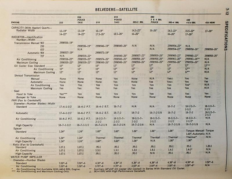

If you do as ODZKing suggests and use the A/C water pump, you'll need a different pulley as well since that pump runs at a different speed. Here's a chart with the water pump to crankshaft ratio:

Thanks, I'll definitely get the new pump along with the pulley, fan, clutch, and shroud over the winter. Time to scour eBay and the forums. Then I'll upgrade the Alternator before purchasing the compressor and vintage air kit.
