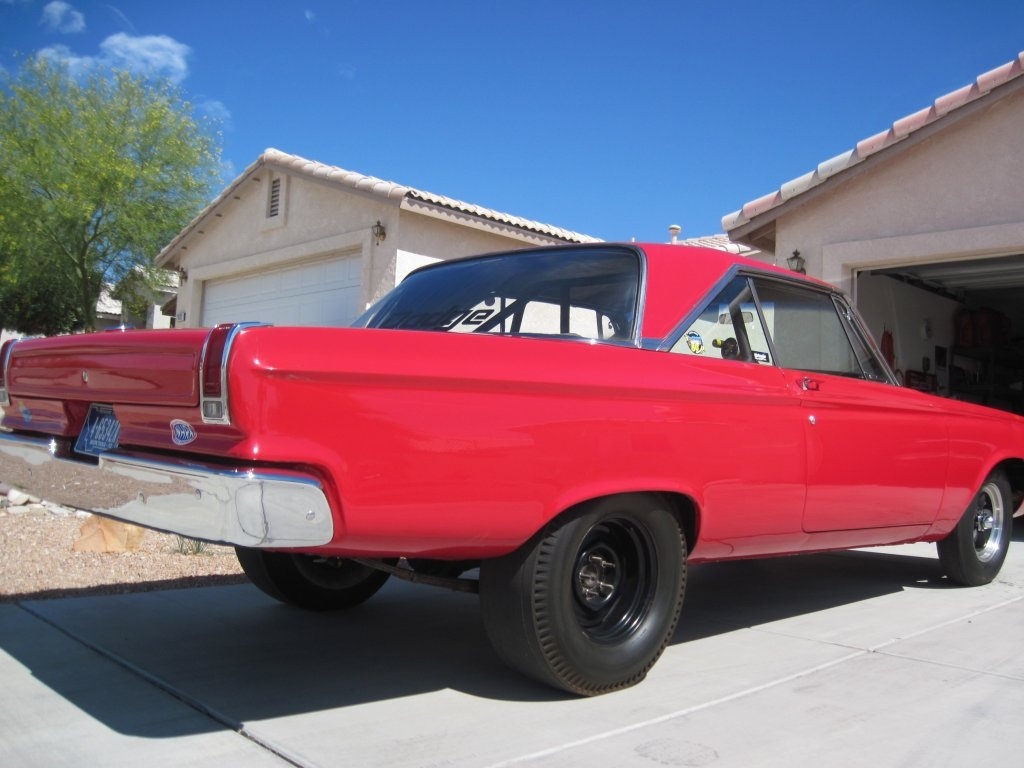

My 65 is not tubbed and I still have an inch of width at the top. My M/T cheaters are 8.20 x 15 on 8" black steelies.
that's the look! man that looks so killer. thanks for the pic! is that a 29" tall tire? do you suggest M/T over radir? do you know the backspacing on the rim?
Yes, they are 29".....I can't remember the backspacing. I'm not home and won't be back until mid September, if you're not in a hurry I will check it out for you when I get back. As far as brand choice I am not familiar with Radir, sorry.
