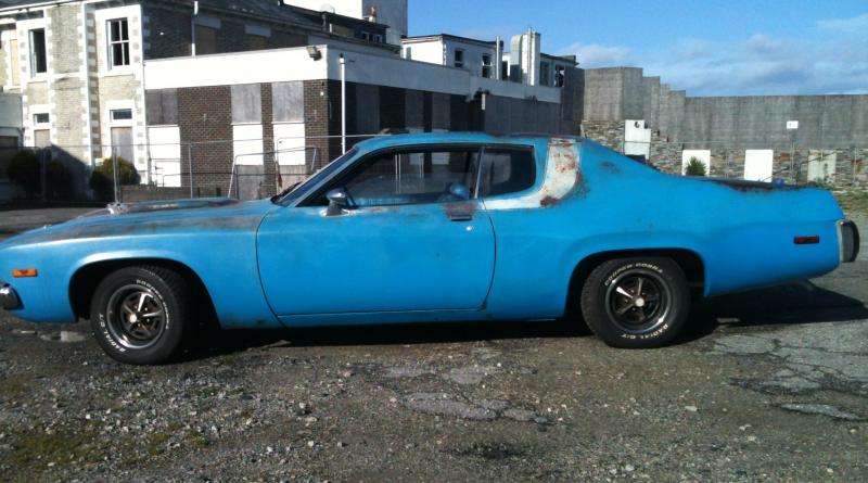

Someone ruined the trunk lid.The spolier is way off location.Other than that it loks like a nice car.
I've been following this thread with great interest. Over here (the UK) you can only buy what is available, so i ended up paying 8K for my 73 340 Roadrunner and reading this thread, i almost feel embarrassed at what i spent. Its a documented two owner car with toasted interior, but with all renewed drive train/brakes/steering etc...You guys really do have so many options to choose the right car. Best of luck to the OP with his pursuit of the 'right car'!
Man, you keep adding to the mystery! :) So Mecum sold this car at auction in 2010 as a 22k mile car, and the car now has just 22,122 miles on it, so the guy who bought it has only driven it 122 miles or so in two plus years? I might buy that if this were a top-end show car, but this car??? As for Mecum, like most auction houses, they operate on an "owner represents" basis, meaning the owner signs a statement declaring the vitals of the car. This lets the auction house off the hook if the data is later found to be in error so they generally don't do much research into a car's history unless there's some special interest associated with it.
