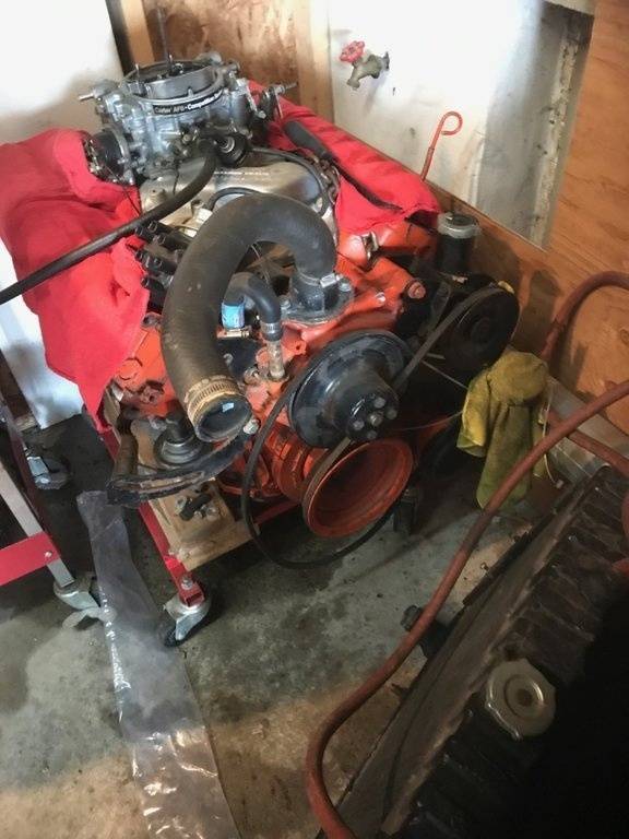

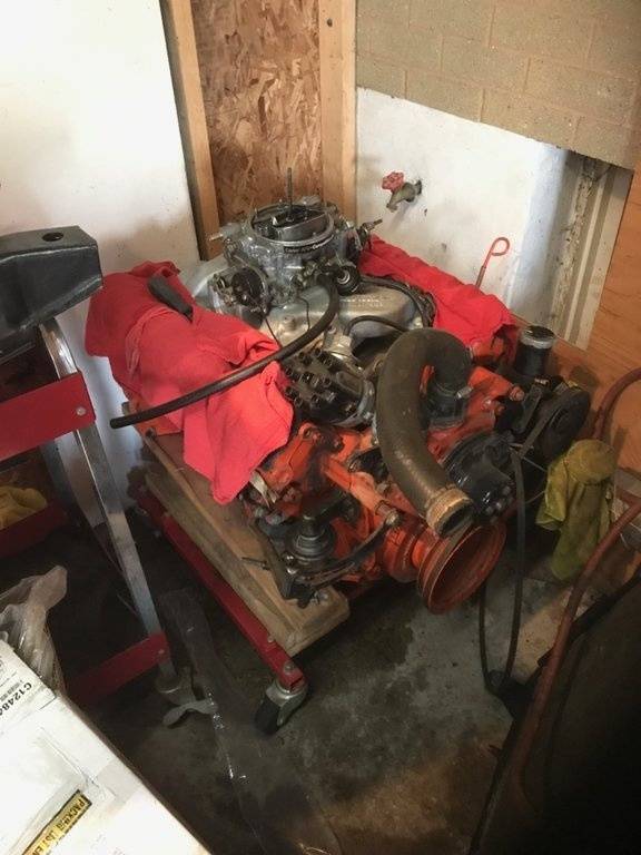

This is whats being offered to me right now. Its complete as it gets for 1500.00cad. Includes: Power Steering Pump, Alternator, Starter Carb, distributor, Fan, Kickdown Linkage, has updated MOPAR Performance purple cams and lifters and he believes the cam to be a 480 lift, MOPAR Performance Valve Covers and Air Cleaner cover.
One thing that's always ideal is overdrives, don't know what your budget is but it's the best money spent for a cruiser. For $1,500 I'd want to hear it run and have a peak inside, 383's are pretty cheap.
