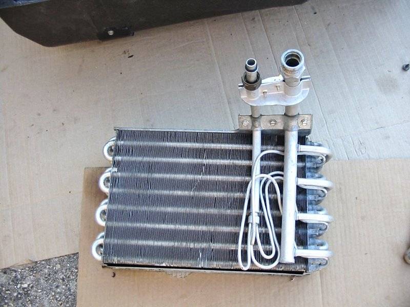

I'm leaning towards evaporator myself. My A Body friend says he's never seen one go bad as the Mopar design is very robust. You'd think 100psi would have been leaking and hissing away in that heater box.
Being involved in HVAC for almost 50 years, I can GUARANTEE they can leak. See attached pics showing holes (leaks) found in 2 tube bends. This was from a 73: Challenger I once owned.
Ron
IMO if freon leaks out in 20-30 minutes no way in hell will the evap will hold vacuum for 30 minutes and / or not show some signs of dye in the condensation drain.
IMO if freon leaks out in 20-30 minutes now way in hell will the evap will hold vacuum for 30 minutes and / or not show some signs of dye in the condensation drain.
The "U" shaped return bends are almost, if not impossible, to successfully repair, due to being so thin from forming and swaging, even if using Heli-arc. IMO.... your long term success will likely be to replace the coil assembly. Another possible leak point is the compressor crankshaft shaft seal.....a simple carbon vs ceramic cartridge assembly; its subject to failure due to radial shock loads when the magnetic clutch engages at high RPM......

I understand that.
But if it looses charge that fast. There is signs somewhere .
And imo. The evap condensation drain will / should show some signs of dye .
This my former car.
I had the box apart to replace heater core.
I pressure tested to evap core with 125psi line pressure and submerged it in water.
No signs of a leak anywhere.
Not saying it's not the cause .
But I have serious doubts it's the evap
Again. IMO only

Since you've pressure tested to 125 # without leaks, have you pressure tested the condenser as its subject to higher pressures? How about the remaining tubing, connections, dryer, pressures switch. Since you've added dye, the leak SHOULD BE EVIDENT. The condenser is subject to road debris and it's hi operating pressures......just saying.....
