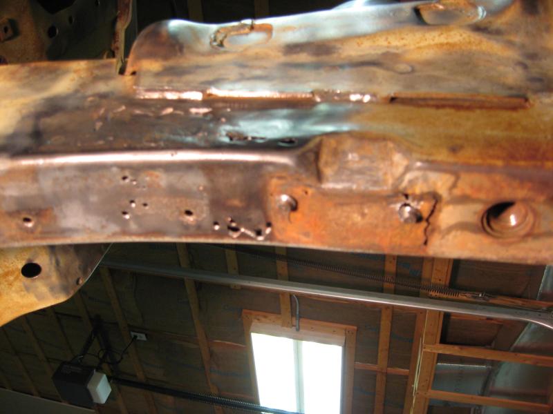

Here is a pic of the LH rail. Holes were obviously smaller until I hit them with a wire brush. Thinking about cutting out a rectangle around the cancer and replacing with new. Not sure if these holes are too large for plug welding. Might be worth a shot to see if they blow out before I start cutting on the rail. This is the worst side. The bottom of the rail directly underneath this section has a few holes in about a 2" area, and in the same location on the inside of the rail has a couple holes like the ones pictured.

if you have holes like that on both sides and the bottom of the rail and
plus where the k bolts up is also screwed up..
i wouldn't monkey around with that many fixes..
i'd be replacing the whole rail myself,
it would be just as much work with better results

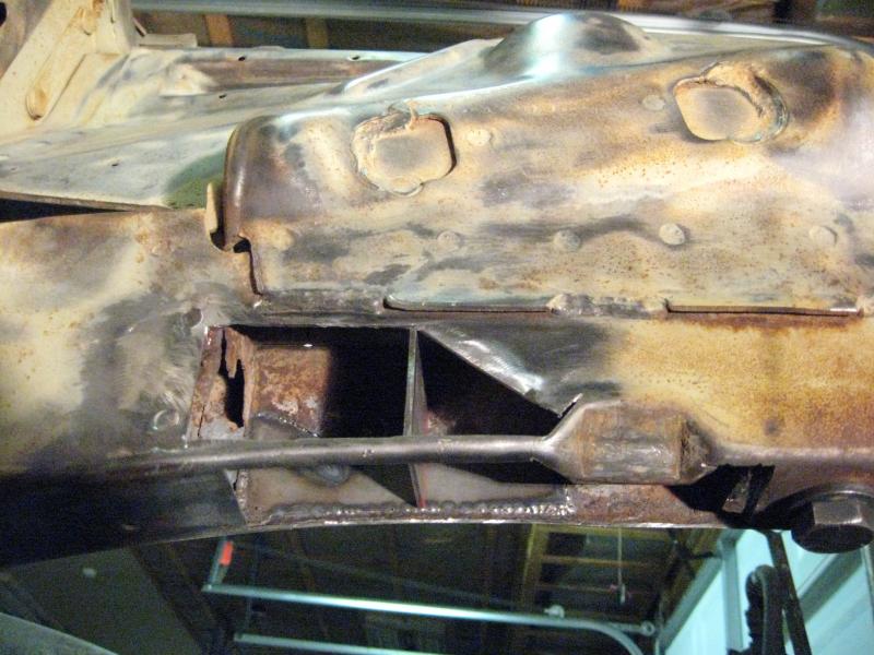

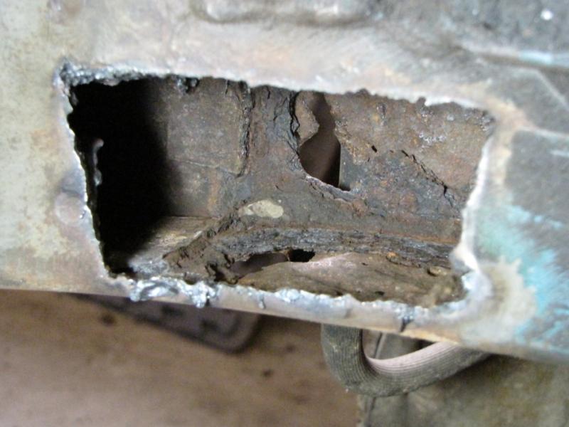

I had an identical issue with the left rail on my Roadrunner. I didn't have the issue with the nut for the k-Frame, but the rail was rotted in the same spot as yours. While initially taking all the paint/rust/grease/primer down to clean metal I ended up opening holes in the frame rail just like you did.

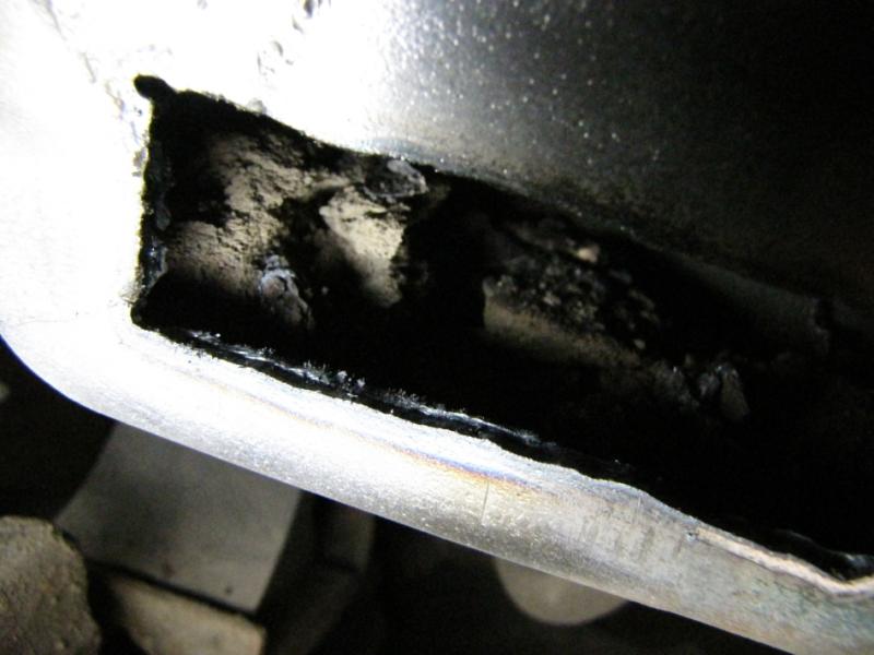

Fired up my hypertherm Plasma Cutter and this is what I found inside:
With the geometry of the rails and the factory openings/holes up front, this area is the perfect collection point for all the road debris/dirt/gravel/moisture to collect. What was left of the rail after cleaning it all out:

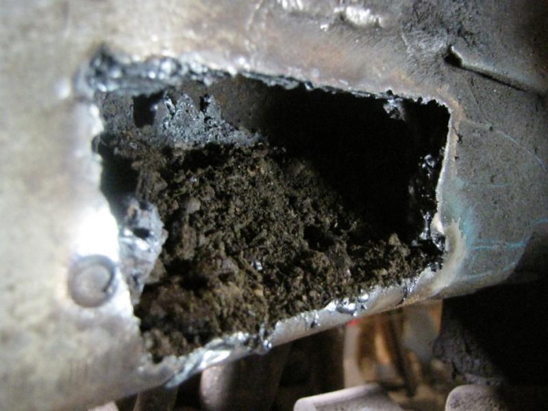

Right rail didn't look as bad and no thru wall wire wheeling, but never the less I still cut a hole and what do you know.....Filled with garbage, but metal was still good:

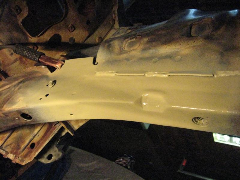

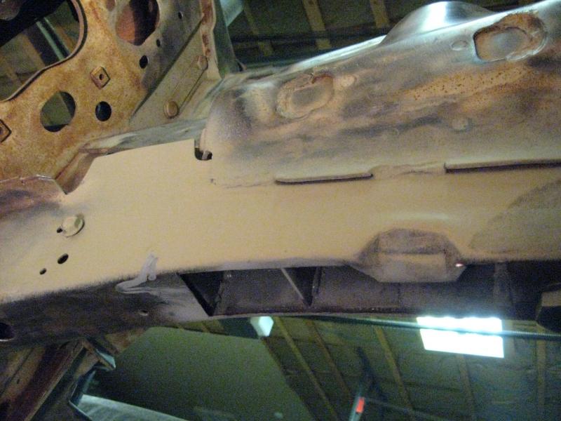

As far as the fix........Again, used the plasma cutter to slice up 10 gauge (thicker than factory) repair patches to be "U" shaped around the rail. Cut out the rot till I found decent metal. Used a 6HP shop vac to insure all garbage was out of the rails, used a flexible wand with a coaxial spraying head, sprayed in rust converter, then encapsulator, then rust bullet as far as I could get it down in there. Did the same with the right rail.
Morale of the story...cut it out and get it out of there. Depending on what you have to work with once it's cleaned out, I would try to save the rail if you can. Changing out a front rail is serious business and if you do not have experience doing it and a rail change is needed, take it to someone that knows what they're doing. Being off just a small bit, your car will not be road safe, won't go down the road straight, wear out tires in an odd manner, and trying to line up surrounding panels may be an issue as well.

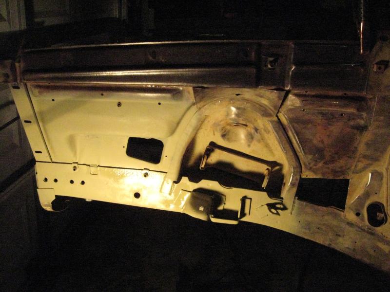

I promised an update so here we go:

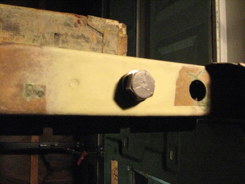

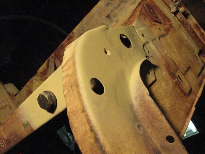

- Right hand rail broken jam nut: Since it was the front nut closest to the radiator support, I worked the stud/nut to the front of the rail against the radiator support. I drilled out the spot welds and loosened the lower support which exposed the end of the rail (which is tabbed over by the way). I gently pried open the end of the rail tabs enough to allow the nut to pass through the end of rail opening. I drilled out the two spot welds which held the large plate to the rail and passed that through the opening as well. I removed a weld nut/ plate assembly from a chunk of donor rail I had laying around. I cleaned it up, reversed the process and welded it at the spot weld holes I made while removing the old plate. View attachment 103212View attachment 103213

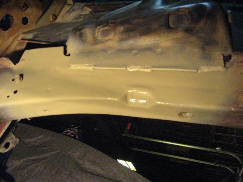

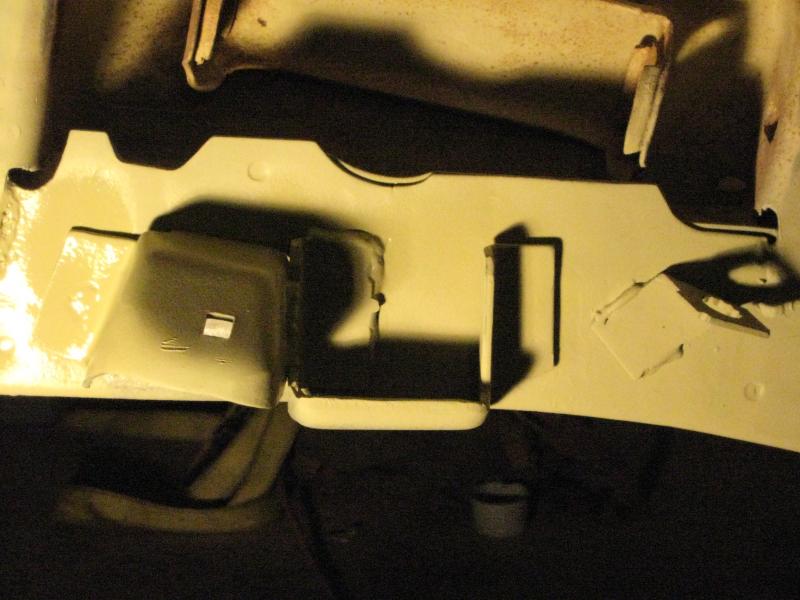

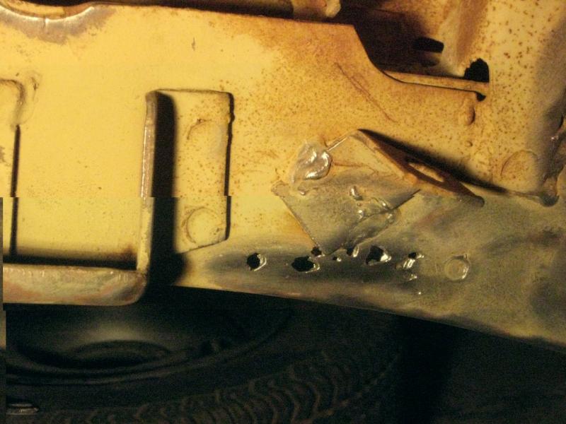

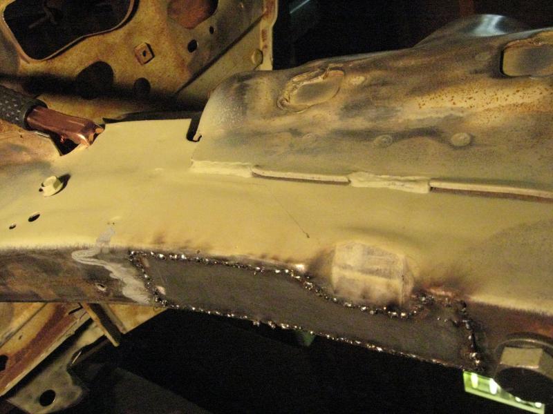

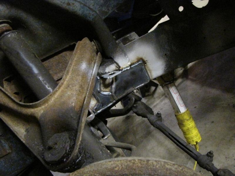

The LH rail rust areas were removed and replaced. After inspection, I decided that the rail was in salvageable condition. Pics are worth a thousand words, so I'll just post them:View attachment 103214View attachment 103215IMG_8011.jpgView attachment 103216View attachment 103217
... overall, not bad for my first time. I also treated the area after welding with a galvanizing primer I bought at Grainger. My Millermatic 140 worked great. Both rails are extremely solid now and I couldn't be happier. I butchered the sequence, but you get the point. IMG_8016.jpgIMG_8017.jpgIMG_8018.jpg
