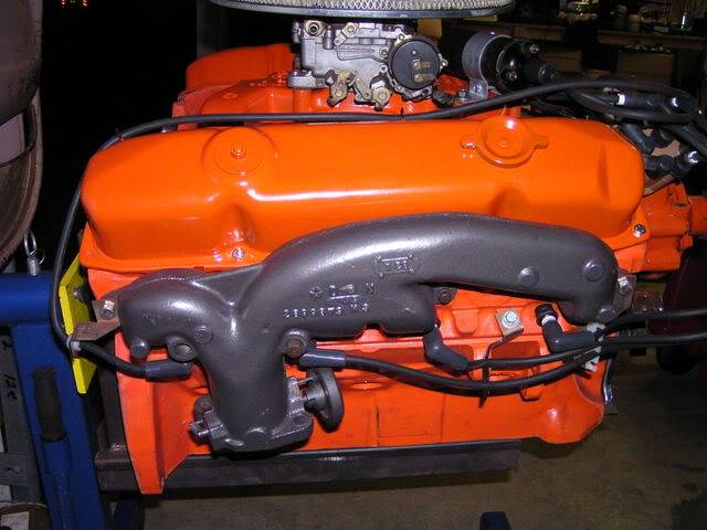

On my 70 Superbird 440 I am missing the spark plug wire holders on the left and right bank that are secured by the head bolts. Has anyone pulled a single head bolt and torque the bolt back down without having any problems. Any information will be greatly appreciated
The plug wire brackets you are talking about attach to the exhaust manifold studs. If the studs were installed correctly the nuts should come off without disturbing the studs. The studs do go into the water jacket, so make sure you are not loosening the stud.
Interesting, those sure aren't factory heads... or my eyes are pooched one or the other.

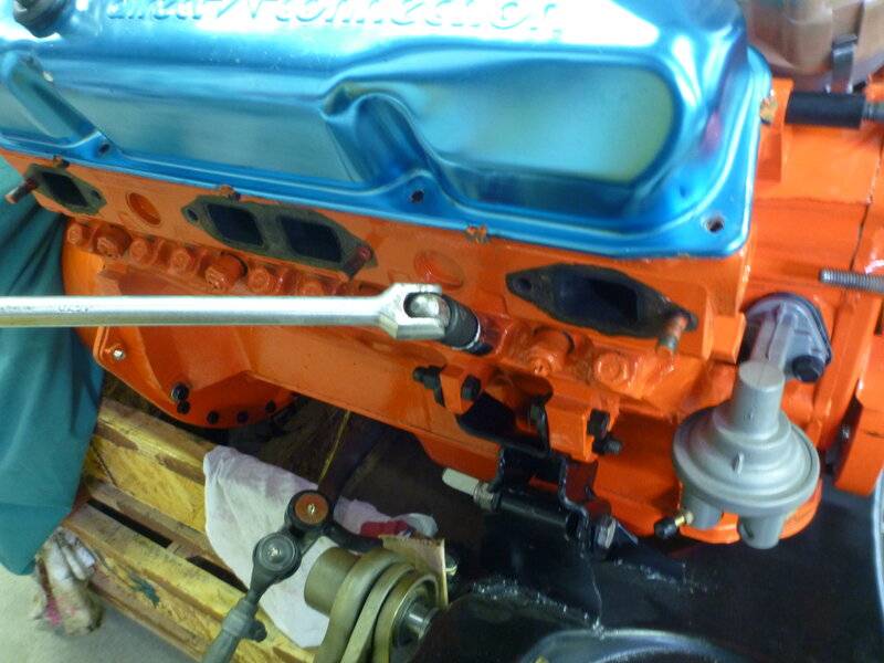

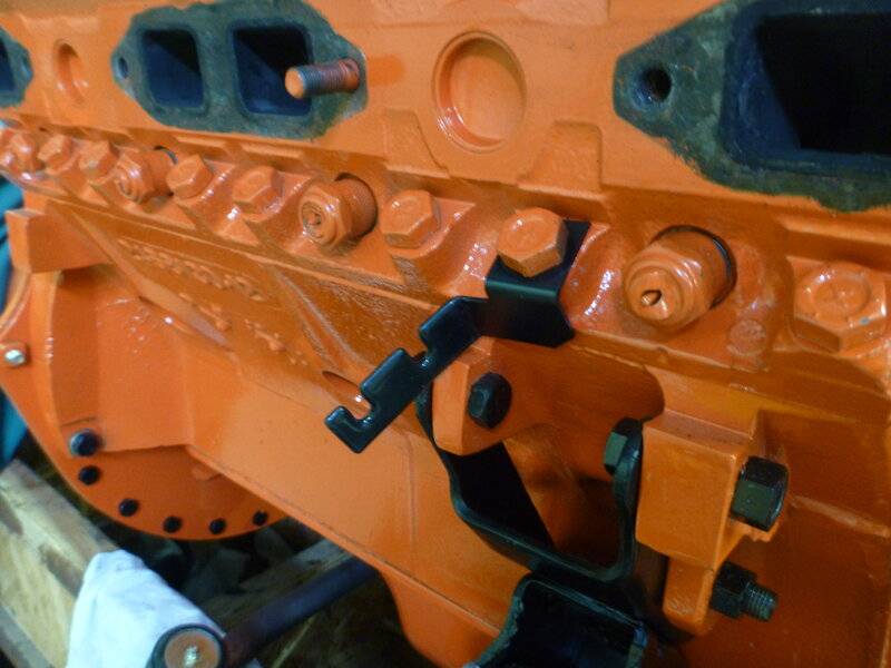

Those were pictures I found online. The fun part is getting the exhaust manifolds off beforehand
The head bolts hold the heads on and a couple of brackets, but no water involved.
