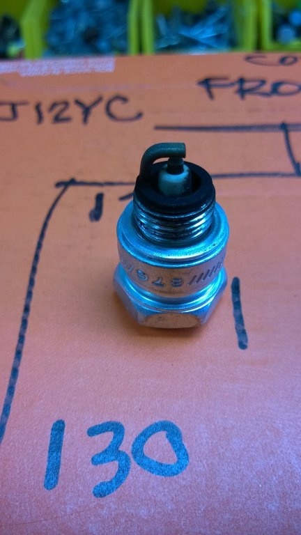

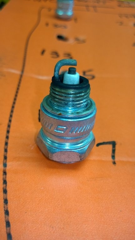

What does?It indicates that you have too much or too little fuel
I see. What plug do you recommend then?Heat range on a spark plug has nothing to do with any of the above. It has to do with how fast heat is transferred from the plug to the head. Those RC12YC plugs are too hot for todays pump gas as far as I'm concerned.
