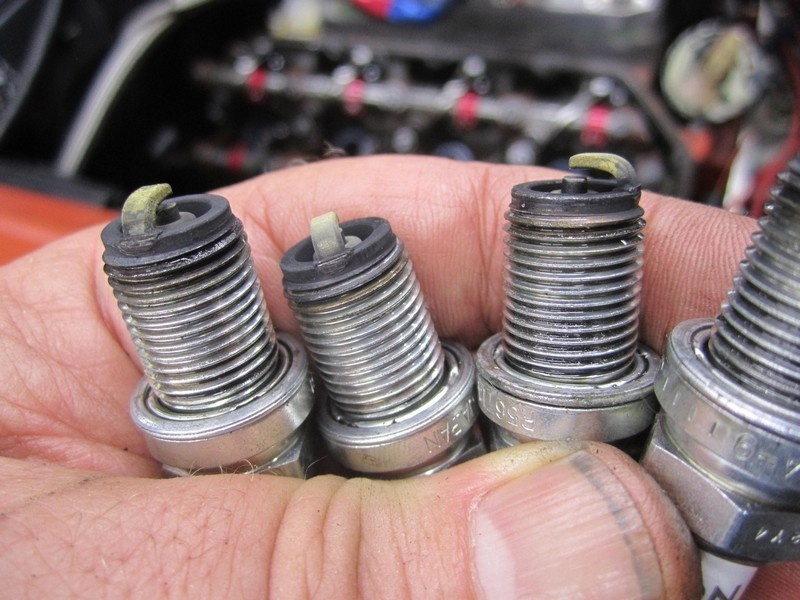

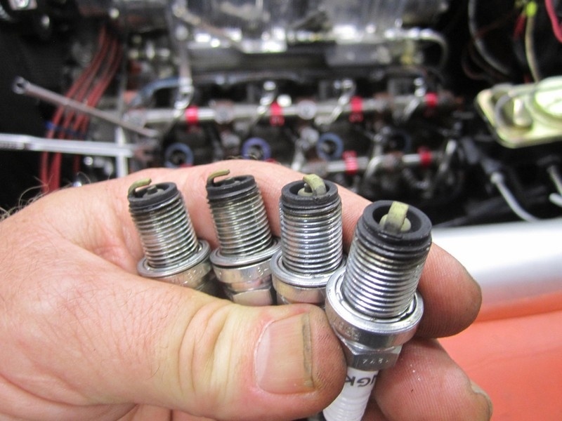

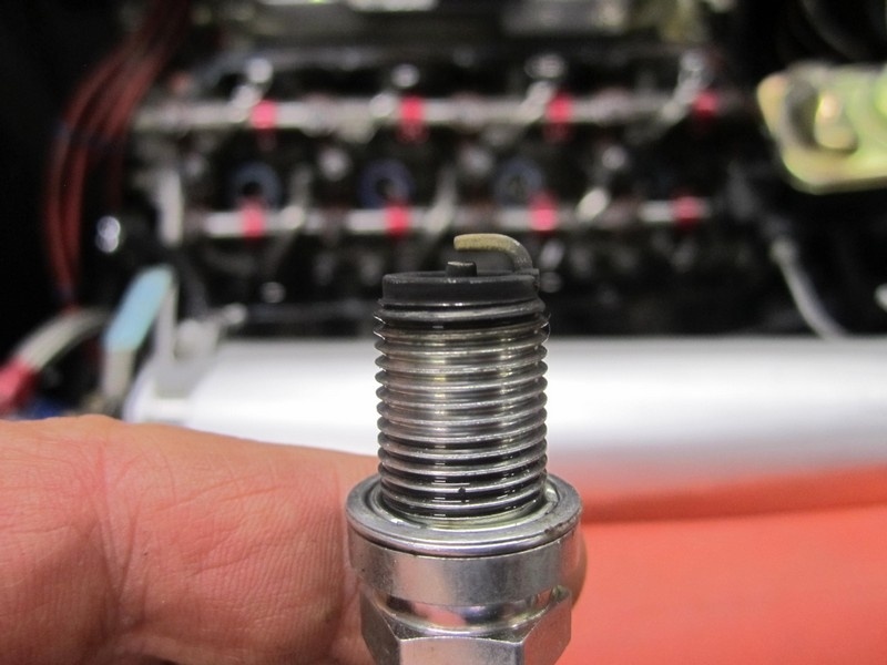

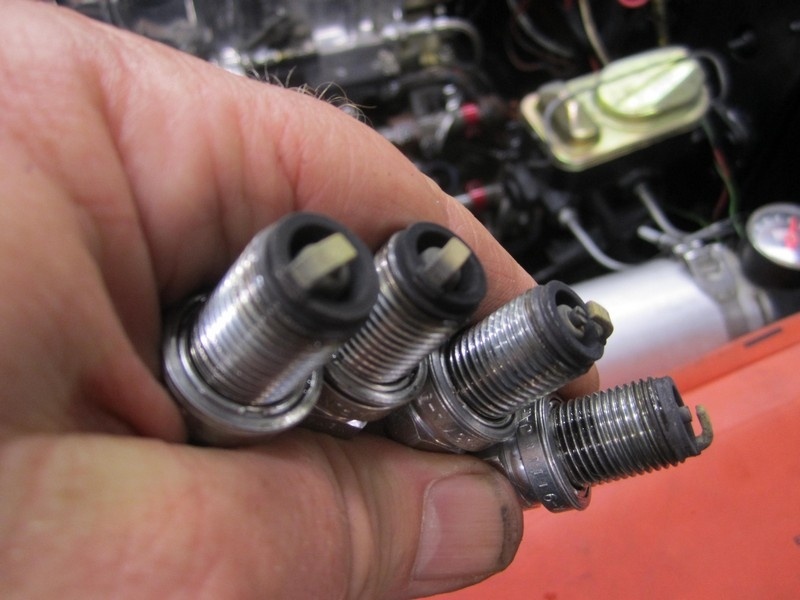

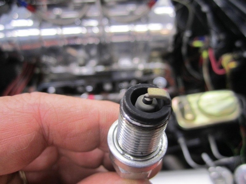

The ground straps are sorta smoky grayish. Lousy pic.https://www.ngksparkplugs.com/about-ngk/spark-plug-101
http://www.dragstuff.com/techarticles/how-to-read-plugs.html
There is no change of color on the strap,you might be a tad lean which might have caused that misfire.

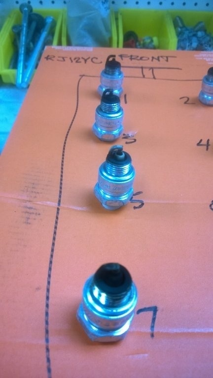

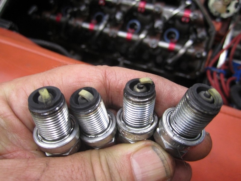

Well, maybe you can. Here's the last set I pulled before I found the ignition problem:
I'd call that progress.
