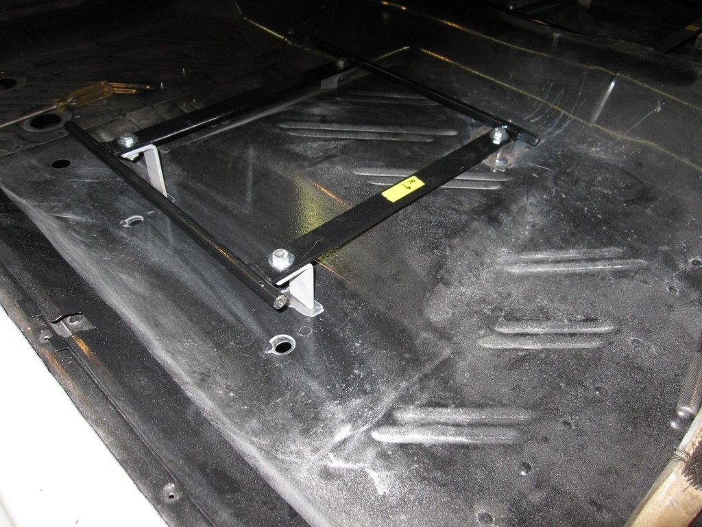

I did install Scat Rally seat brackets in my 65 and it was "involved" but turned out great. The brackets are totally "universal" so welding is required.

I set the brackets as close as possible to the floor, in fact I had to cut off the lowest mounting holes on the inside seat attachment (3 holes ). I used steel blocks on the front inner bracket mounts (welded to floor with a drilled and tapped hole) and the supplied universal weld on attachment "angles" for the other 3 corners. The seat height turned out good for me (6' tall, long torso).

I think you could bend 3 of the 4 brackets into a "C" shape to allow bolting through the floor and use a spacer on the front inner (too short for a "C" shape) to allow a longer bolt for attachment. Be sure to use fender washers on the bottom side.

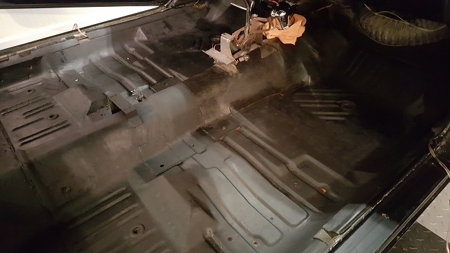

I bit the bullet and ordered a set of ProCar Rally 1000's and the brackets. I was getting the interior ready to replace the carpets and thought might as well do it now....
