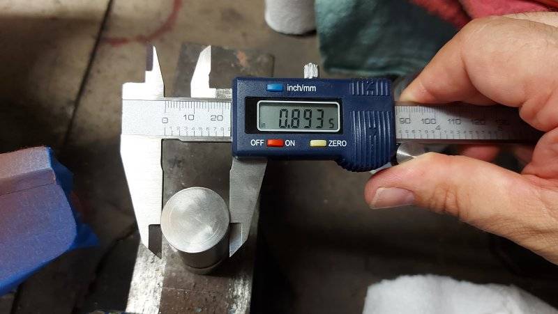

So tonight I took some measurements.
I started with one of the lifters that was turning.
Then I measured the 3 that were not turning.

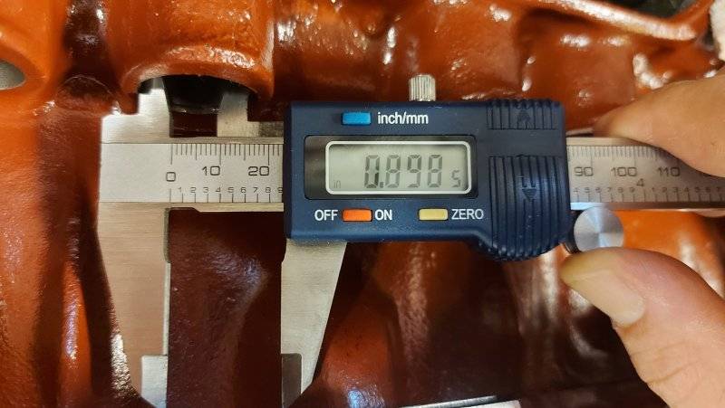

Next I measured the lifter bores.
So my next question to you guys is...should I buy the Isky solid lifters or with another high end manufacturer like Crower or Lunanti?
