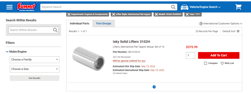

Looking on the Summit website I see the Isky solid lifter is a sold body design that does not have the outside band with the oil hole.
Would this lifter work?
Or does it have to have the outside oiling hole?
