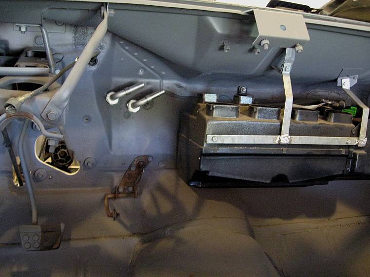

Do yourself a favor and go with Vintage Air. Their stuff is first class and they make systems that will fit just about anything. I'm using one of their universal heat/air/defrost systems for my '64 Dodge and it fits under the dash perfectly.

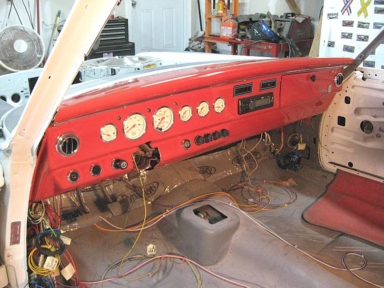

I did a custom dash with vents but they have under dash units too.

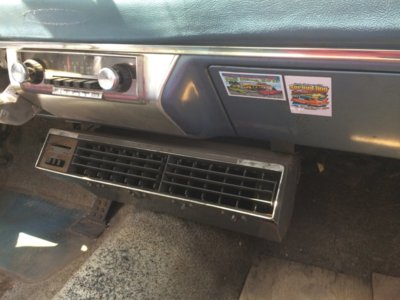

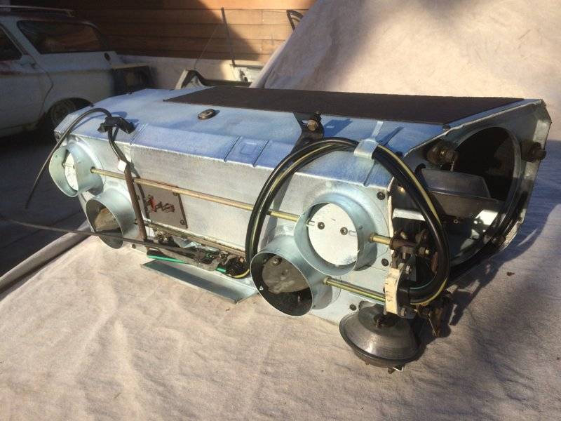

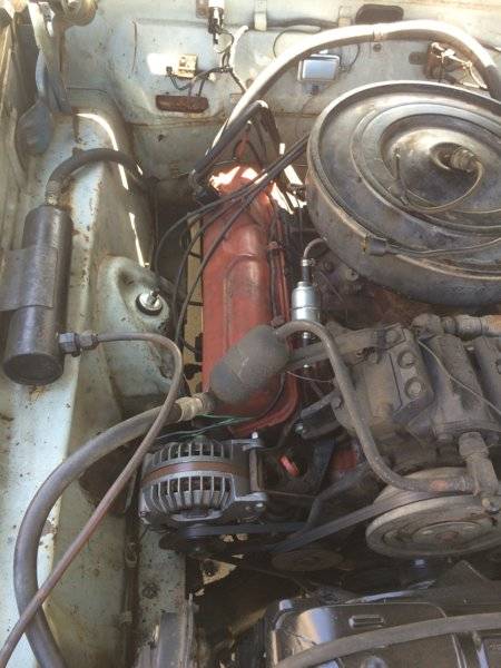

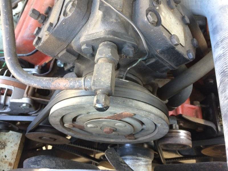

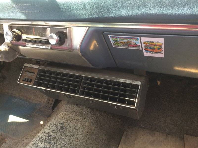

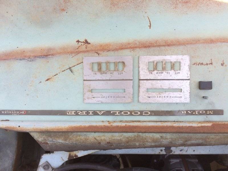

Why not run this sweet dealer-installed Airtemp system? It was working and blowing cold on a R-134 charge when I pulled it. I only changed it out because I have enough spare parts to do a factory A/C system. Yuma is not that far from LA. I'll practically give it to you. Come get during Fall Fling or pay the shipping. I can pallet or box. Everything except the condenser and pump are already in a large Rubbermaid container. The last picture is the factory A/C unit from a 65 B-body I restored.

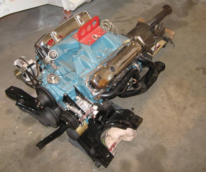

Total cost for the universal system I used was $490 but that was just the evaporator. The controls were an additional $50 or so.. (they have a few different types of controls). I purchased the Sanden compressor/bracket kit from https://www.bouchillonperformance.com/inc/sdetail/568 . This one mounts the compressor where the power steering pump normally lives. I didn't want the compressor in the stock location messing up the look of the engine installation and I'm not running PS. This is just one of the several mounts they have for B/RB and small block installations.
When it comes to the rest of the system I purchased the hoses and fittings from Vintage Air and made them up myself with the use of a AC clamping tool borrowed from a friend. Bought the Dryer from Vintage Air and the condensor from E-Bay. The whole system ran between $700-$800.

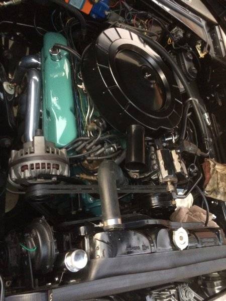

Haha. That's exactly the opposite of my thinking but to each their own. I love the RV2 and how it looks. I can still see the engine. BUT, gotta love the options we have in doing Mopars now days as options which way to go are like no other in time for our hobby. Darn expensive of course. I did this factory A/C install on a non-A/C car and without a big block A/C parts car for reference and parts. This looks like a pre-mid-63 383 2bbl with 4-bolt valve covers and 324 casting heads. It's a 472ci 400 block with FAST XFi 2.0 controller.
