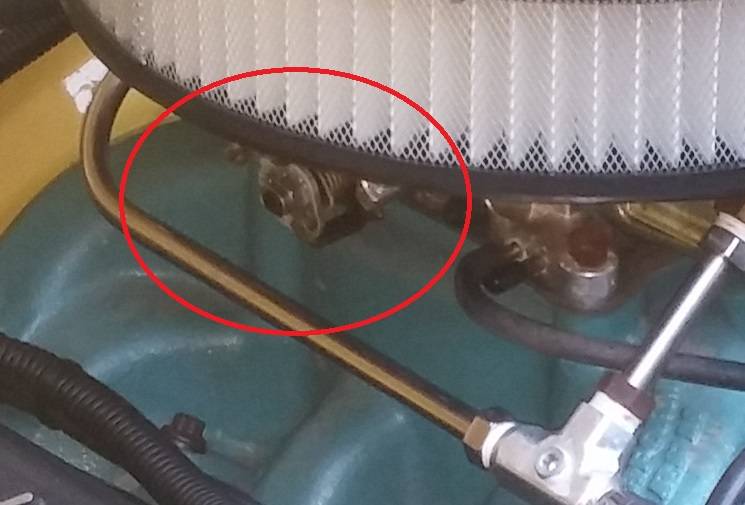

Hey Steve,.... One thing to watch out for on the Performer is if the choke horn will clear the throttle linkage on the passenger side.
I can't say for sure on the 383 with the Street Demon, but I DO know that I tried mounting a Speed Demon (Holley style dual-bowl carb) on my 440 I built for my Charger. The passenger side linkage arms, for the primary butterflies, hit the choke horn on the intake. I didn't have room to add a spacer under the carb, so I ended up machining away part of the choke horn for it to clear.
Like I said,... I don't know if the 383 Performer intake will be different, or how alike the primary shafts are between a Street Demon and a Speed Demon. Just wanted to let you know to check it.
The picture I am including is not from the Charger, it is from my Barracuda which is a 400 and has a Performer RPM, that doesn't have the choke horn like the regular Performer has. Just trying to show you what parts interfered with the choke horn on the Performer intake.
