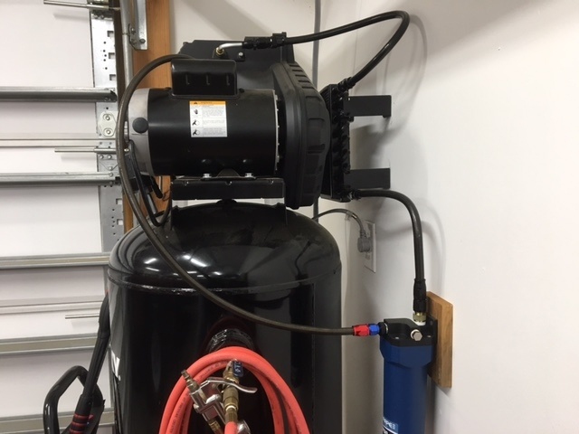

Here is a mod that will help and that is a aftercooler. It will drop moisture out of your air. There are some DIY videos on it also.
I just did this mod on my compressor. I used a Derale cooler, https://www.amazon.com/gp/product/B004XONT3E/ref=oh_aui_detailpage_o00_s01?ie=UTF8&psc=1
The cooler has -8an fittings so I just made the an lines.
The temp difference between the input and output can be as much as a 100 degrees when running. Its mounted so the flywheel cools it. I leave the dryer slightly cracked and the water just drips out of it before it enters the tank. Makes a hugh difference in the moisture in the tank. Next up is to run my steel lines.
