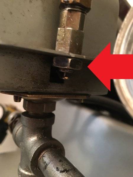

The regulator can be adjusted - there is the main connection to the tank and then there is a line (usually flexible) that triggers the shutoff. There is an adjustment at that line.

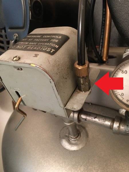

So you replaced the governor/pressure switch or the regulator? If the pressure switch what’s the psi range on it?
the small tubing that Stanton has a pic of is the unloader valve that relives the pressure off the pump so it doesn’t start under a load and has nothing to do with the cutoff pressure. Ever noticed when the compressor turns off you hear that short hiss of air? that comes from the pump and lines leading into the tank.
A check valve between the line from the pump to tank prevents the air from leaking out through the unloader valve.
To adjust the pressure switch remove the cover and there’s a nut or a screw turn it a half a turn usually clockwise
to increase the cutoff pressure depending on the actual switch you might need to go counter clockwise.
