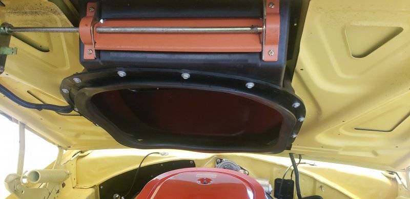

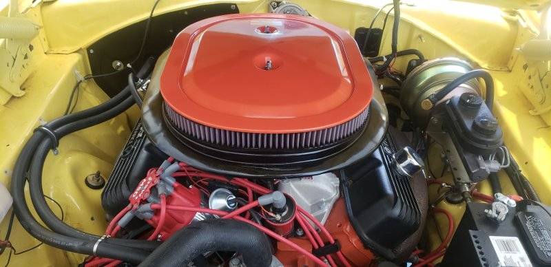

My friend has a 440 with an Edelbrock Performer RPM intake the issue he is having is that the intake sits up about an inch and a 1/4 too high. What intake besides a stock 440 intake will fit with a 70 air grabber setup.
First, make sure it's a 440 base on the air cleaner, which is shorter than the 383 base. The four barrel air cleaners used a round top, where is that oval top from...a six barrel?

That makes sense.Im confused. I just checked out nicksgarage air cleaner page. And now I'm even more confused. I guess all 70 440-4barrels got the round covers? The one he has is possibly a 69 or 70 for a 6-pack?

OK I just talked to him and he knows its supposed to be the round one. But he wanted the oval style because he likes it better. So I guess we are back to a shorter intake. I did see on that page how to tell the 383 and the 440 ones apart. So I will have him check that to see if its the correct one.

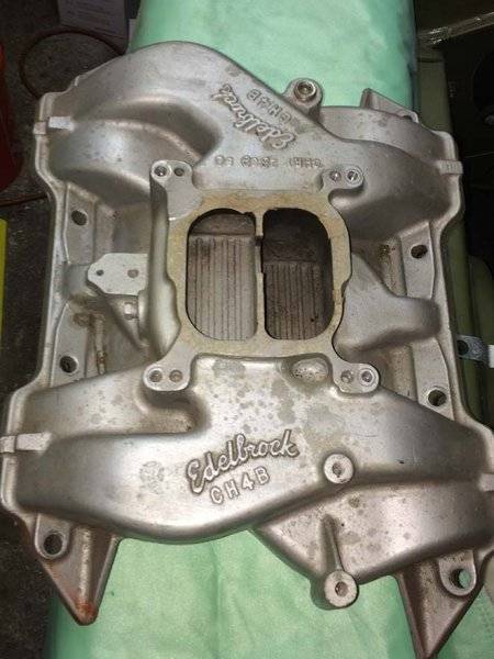

These are the 2 that I found in my internet search. So I guess I'm on the hunt for one of the 2.

Go with the old CH4B. Even has a stock part numbers and flows very well for an old style manifold.
I figured out the fit issue today when trying to install the 4bb air cleaner. The engine is sitting back too far due to the QA1 Tubular K Frame. With the base on it hits the wiper motor just a tad. Installed a ch4b the height is perfect but the engine sits too far back in the K-frame.
