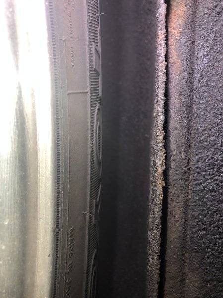

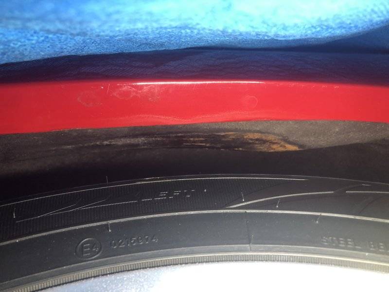

What prompted this thread was that over the summer, I had a 220lb friend sitting in back, and 2 of us in the front. I heard the tires rub on a couple of bumps.
So... after reading some of the responses to this thread and realizing the air over leafs may not be my best idea...I went out into my shop and looked at the car again.
It turns out what I really heard was One tire, not both tires.
this is what happens when you let a car sit for 8 years.... you forget what you actually did to it before lol. I had stated that the humps in the outer wheel houses were removed. I was half right. We only did the drivers side- the side which has zero witness marks and in fact, the tires generally have a lot of room. I was in no rush to go back to my friends house to do the pass side because this wasn't an issue unless I had full size people in the back. At the time my kids were young and between the two of them, they weighed 100 lbs.
i've got 2 5/8" between the tire and the quarter... without rolling the lip. I've got more than 1" between the tire and the inner wheel well.
Basically I started this discussion for nothing. My apologies. Oh, as if I didn't f up enough aleady. my tires are 295/45/18, not 295/50/18
Outer clearance and witness mark
Inner clearance.
