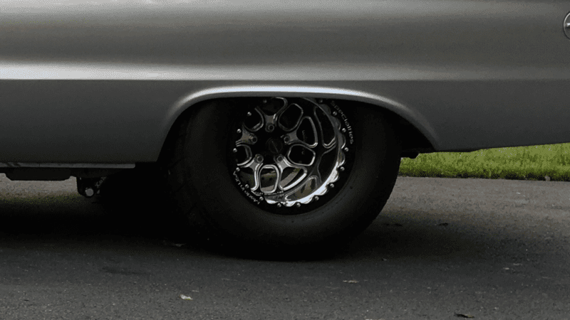

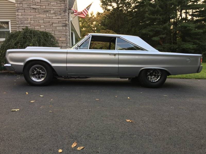

So I took the Satellite to the alignment shop this morning and after making the appointment with the car present last week, today the tech guy tells me they can't get the gauge on the rear wheels So they cant do the alignment.
So I left and called a bunch of other places around including some race car shops and was told the same thing. My issue is the rear tire is tucked under the quarter to much and there is no way to get the clamp on the rim and spin it for calibration.
Not sure what to do now...The car is pretty fresh and pulls hard to the right if I let go of the wheel.
Anyone have any ideas maybe a different type of alignment rack maybe older.

Lift the rear (air shocks ) let them align it the go back to what you had ! This won't hurt anything
How about a block of wood between the frame and rear?
Lift it only high enough to clear no matter which way you go. That way it will not be affecting the alignment much when you let it back down.

I'm not familiar with the process. Is putting a narrower set of wheel/tires on the rear just long enough to do the alignment a possibility, allowing the equipment to function?
They should be able too do it with just two wheels but can not do the four wheel which gives the thrust angles
Or mount the rear heads and not rotate as you can not adjust rear wheels anyway
Had the same problem on my Chevelle. The new Hunter machines do grip the tire to mount the heads. Then they spin the heads for runout and compensation. Had to use a smaller rear wheel/tire combo. The older heads gripped the rim, better in my opinion.

I would try a much smaller offset wheel, so the head can be tucked under the quarter panels.
It looks like you have caltracs and monoleafs, correct?
And just trying to see if the rear end is square? Lowering blocks you can take out?
Caltracs can be preloaded to adjust left or right pull.
Fabo race site has a caltrac tuning thread.
