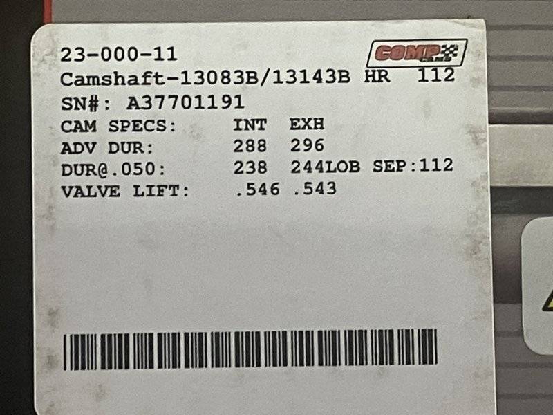

I have a dual plane intake (Edelbrock Performer RPM) and want to keep it for the low and midrange power. I'm switching to a hydraulic roller cam with the following specs:

The lift is actually higher since I have 1.6 ratio rocker arms.... .582 intake and .579 .
The headers are 2" full length and I have 3" exhaust with an X pipe.
