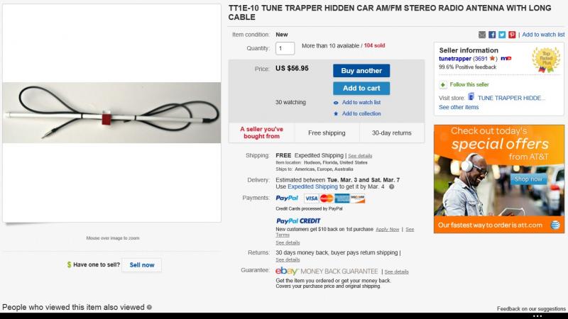

I found a US made, nice quality unit. Not cheap, but seems like it might be amongst one of the better choices. Here is what I got:

I bought the tune trapper that is shown above. It won't work for AM when you put it behind glass metal etc. I talked to the guys who make it and they also told me the same. The AM band is to weak however FM will work with no problem I am told. Just need to convert my radio.
