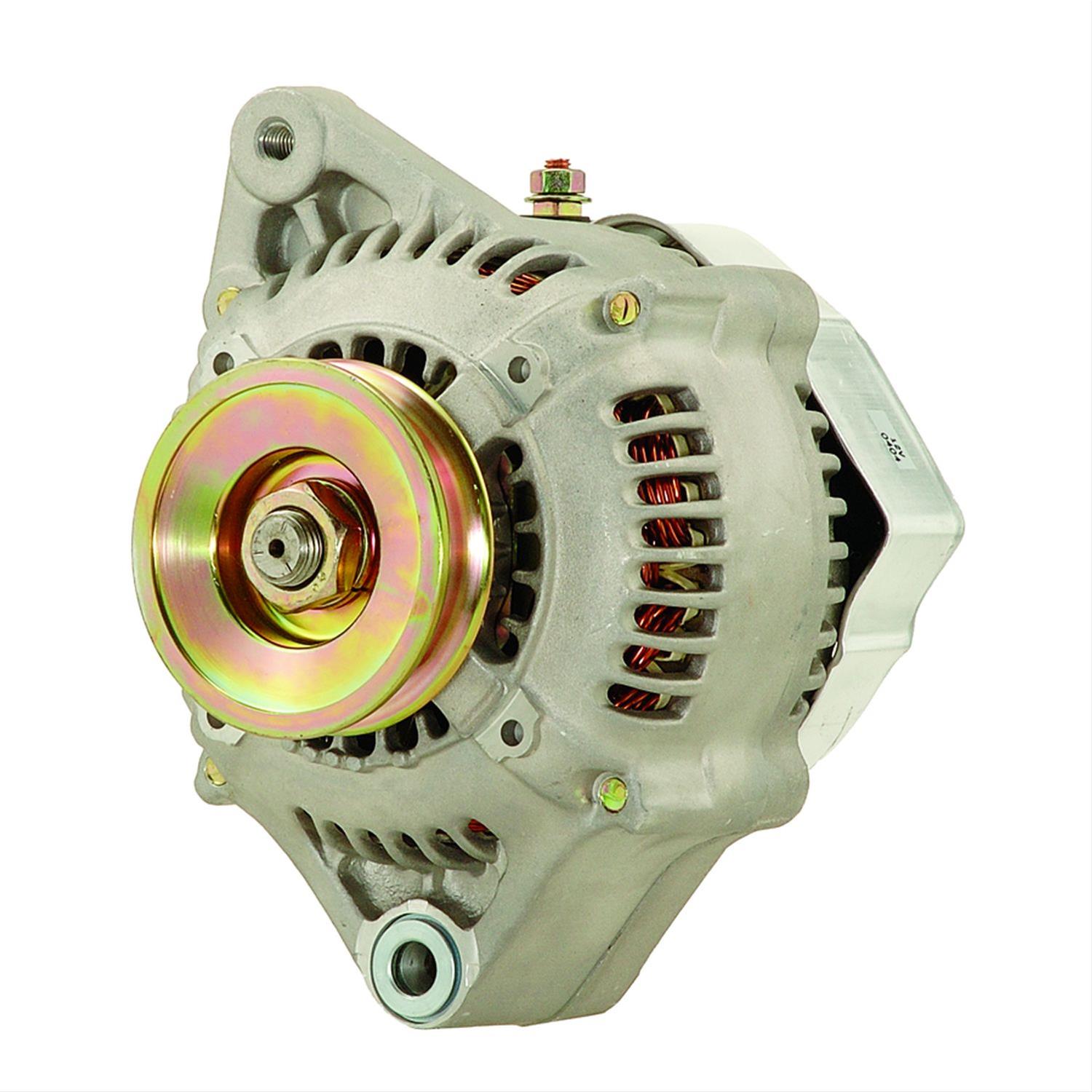

My BB Dart, drive to the track racer, trunk battery, electric water pump, electric fan cooled (manually controlled switched), good battery, and Toyota 1 wire internal reg alt. Keeps up and shows 14v on the Autometer gauge @ 800 rpm idle in gear.
Thoughts on yours'.... regulator issues, wire size as others mentioned (put your hands on the supply wires to see if they feel warm), battery ampacity, and you mentioned 30/40 amp fans, mine too, but that is just a fuse/start-up rating, and should pull a lot less after initial surge start and up and running. Below is the alt I use, and I'm really happy with the internal reg 1 wire set up.
