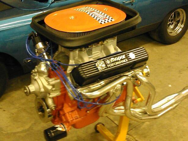

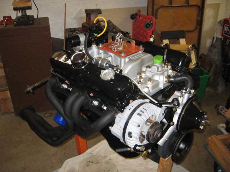

I painted mine.

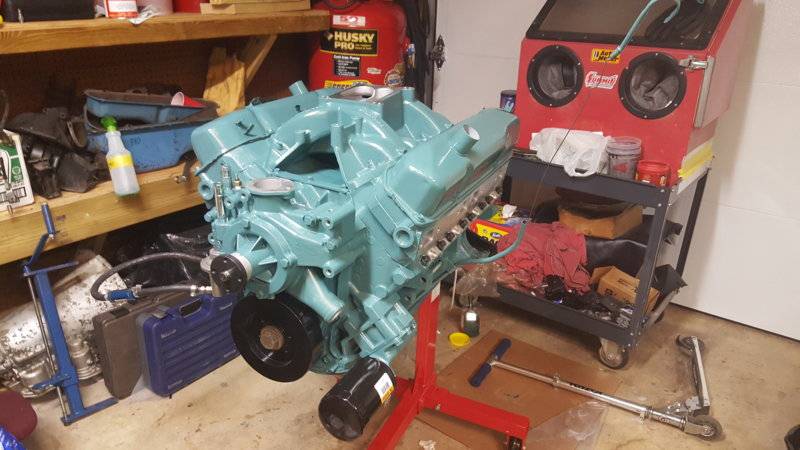

I don't like popping a hood and seeing one solid color where it looks like someone just spray bombed it but that's just me. It looks sharp having a motor broken up with some aluminum parts to me, heads, intake, water pump, etc but to each their own.

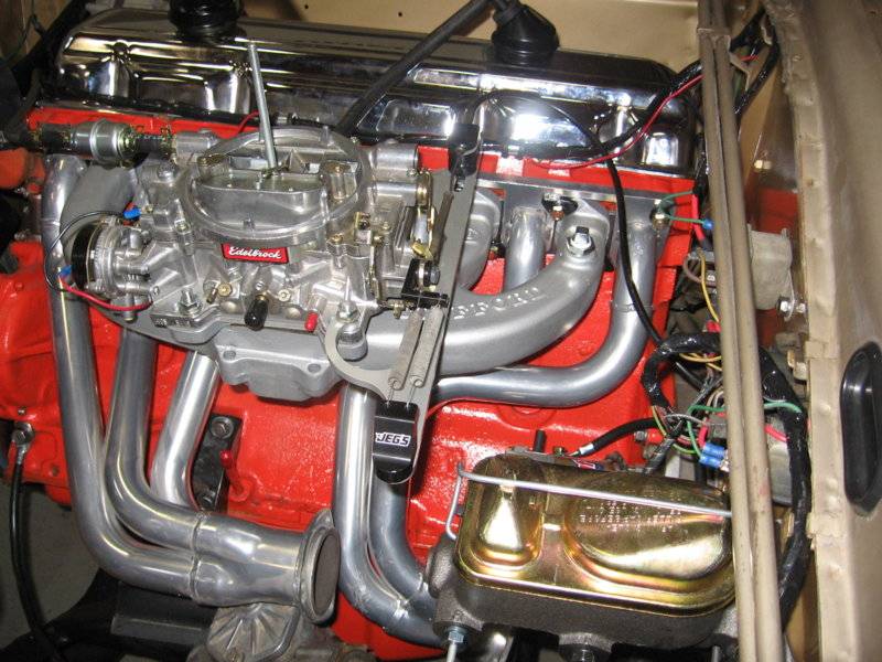

As we all know aluminum gets kinda funky and hard to clean after awhile. I started painting the intakes with Rustoleum ceramic silver. It is fuel resistant and so far has proved to be so. Looks good too.

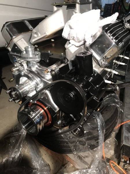

I clear powder-coat aluminum parts. I hate the oxidation of bare metal.

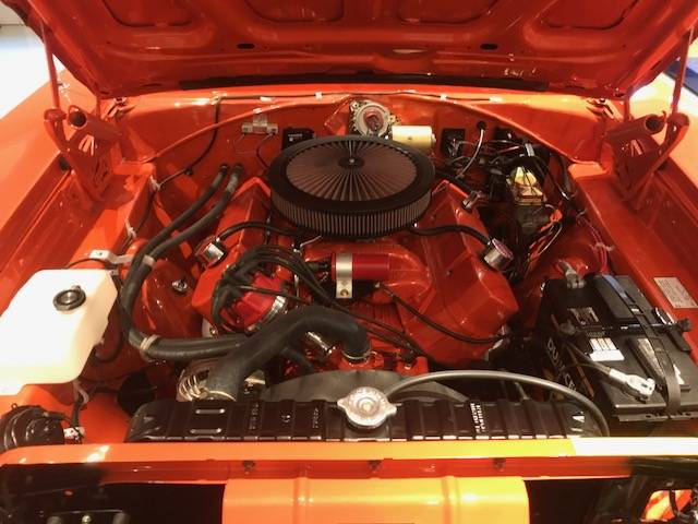

Everything, except the intake. Might sell it, so I don't want to alter it.

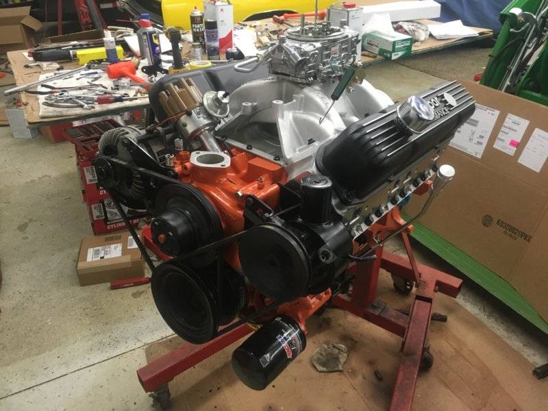

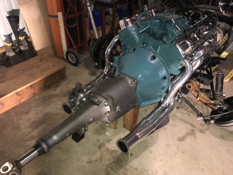

Bare cast aluminum doesnt stay nice long. Polishing is a pain. Paint it with urethene single stage. The small block was painted 16 years ago, the big block 7 years ago.
Doug
