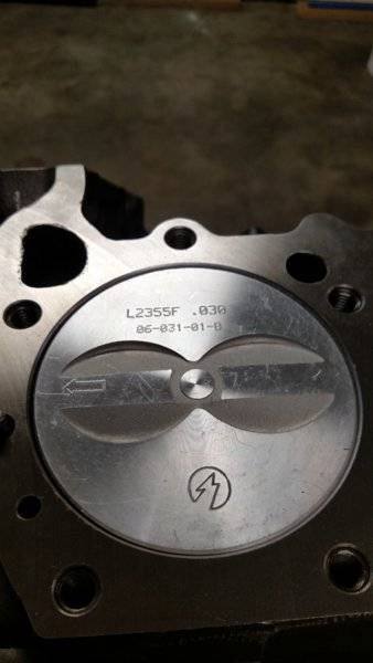

.029" in the hole with 2355 pistons doesn't seem right to me. Is that what you actually measured? I've never seen anyone say those pistons ended up that far down with their 440 build. I measured mine when I swapped from open chamber 452s to close chamber 84cc Edelbrock E Streets and the farthest any of my pistons were down was .010".
And if your pistons are really .029" down in the whole and you use a .027" gasket wouldn't that give you .046" quench?
I measured but I have made mistakes however they are in the hole
And I add 029 & 027 and get 056
am I missing something
I know you cant tell from a picture but here is one from when we assembled the engine
