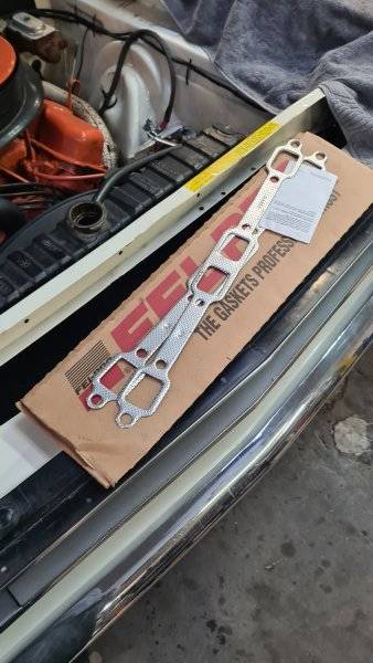

Thank you all for your wisdom!
It was the exhaust gasket leak indeed.
Gasket replaced and everything is quiet as it can be again. Car is ready for a wedding next month!
Glad that's all it was, so no big thing :) If you wanna see some serious panic be at a drag strip when someones converter bolts come lose that REALLY sounds like a knock :)
