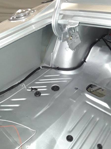

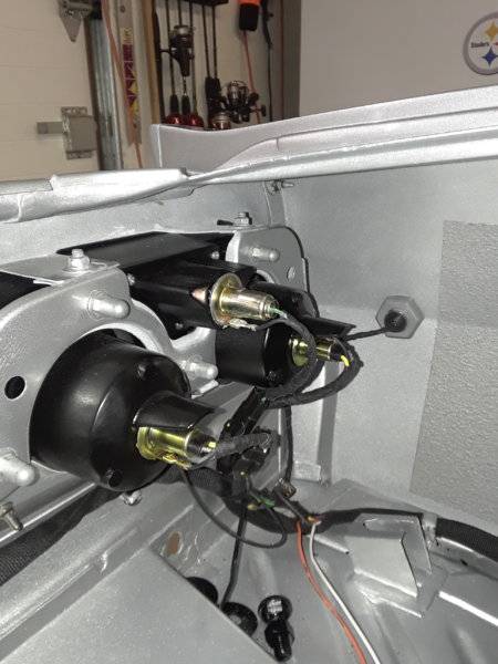

been working on the wiring again have to say it seemed very overwhelming when you first open the box with all the packages but, the blue print style directions have helped. I read ahead and think about it and read again a couple times then actually do it. there is an extra plug for accessories off the fuse box that controls power windows locks, electric fuel pump etc. since i have no power stuff on my car i will be using this for some extra stuff throughout the car. just about finished up the tail lights of the rear body wiring, this is where the crimper comes into play (works very good, you absolutely have to have this.) because you have to custom cut, fit and crimp the connectors on, everything.
specs a ground wire that loops through all the tail lights so no more fked up systems for not grounding, it took me about 6 hours with sleeving everything in cloth shrinkable braided sleeving, gives it a close to factory style look, covers the colors up and adds some protection. after messing with old wires on cars, this is system is definately worth purchasing if your doing a complete resto that is not factory correct.

been working on the wiring again have to say it seemed very overwhelming when you first open the box with all the packages but, the blue print style directions have helped. I read ahead and think about it and read again a couple times then actually do it. there is an extra plug for accessories off the fuse box that controls power windows locks, electric fuel pump etc. since i have no power stuff on my car i will be using this for some extra stuff throughout the car. just about finished up the tail lights of the rear body wiring, this is where the crimper comes into play (works very good, you absolutely have to have this.) because you have to custom cut, fit and crimp the connectors on, everything.View attachment 590071 View attachment 590072 specs a ground wire that loops through all the tail lights so no more fked up systems for not grounding, it took me about 6 hours with sleeving everything in cloth shrinkable braided sleeving, gives it a close to factory style look, covers the colors up and adds some protection. after messing with old wires on cars, this is system is definately worth purchasing if your doing a complete resto that is not factory correct.
