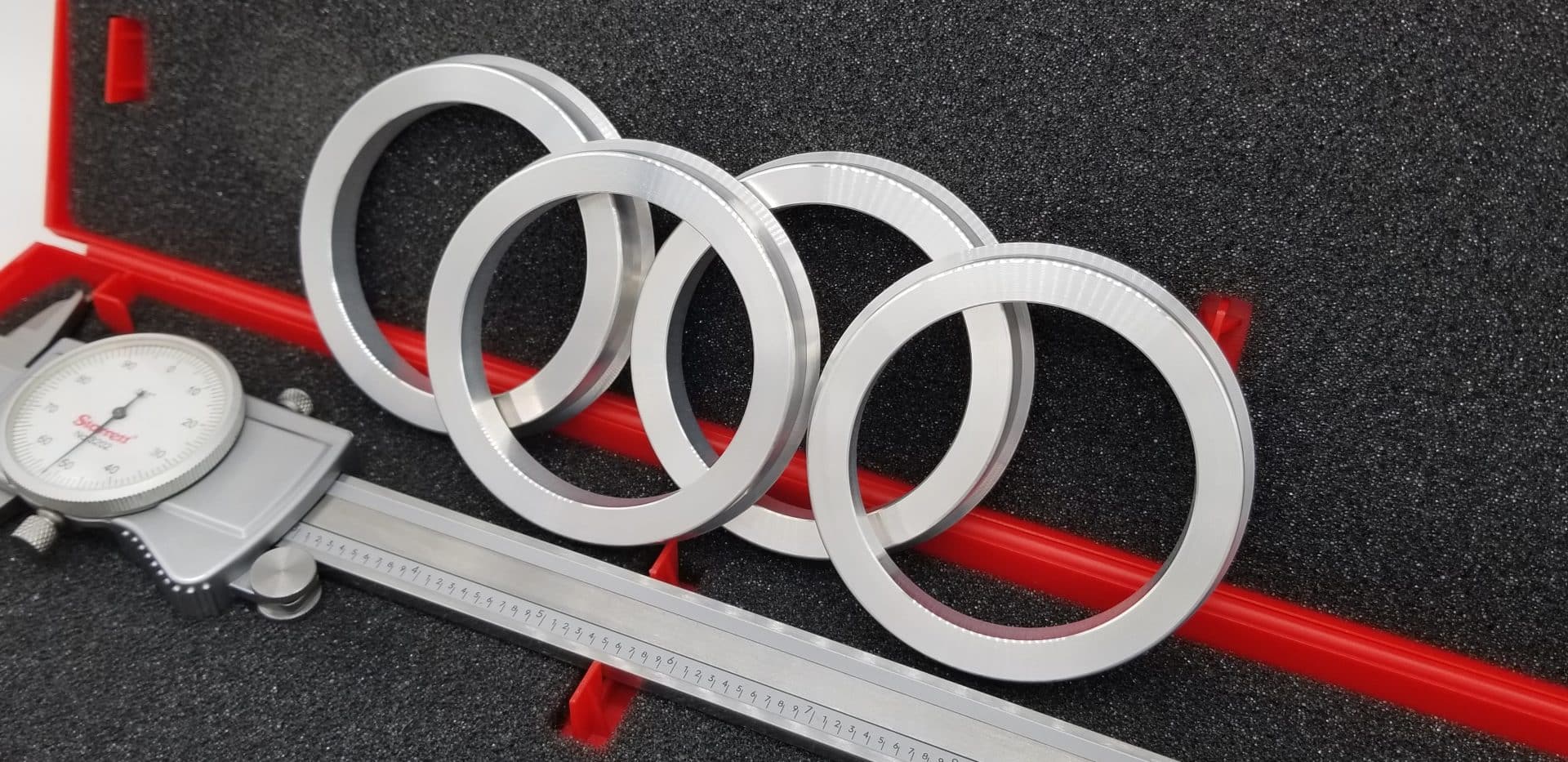

I'm not from Missouri but you're going to have to show me that..(separate hub rings)
Hub-centric adapters...
Nice, I have seen those before but they are not supplied by the wheel manufacturers. I sold wheels years ago at the speed shop and there were no hub adapters available or included.
Actually a few wheel manufacturers do sell them, but most don't.... I know BBS and HRE do...
