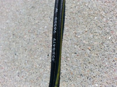

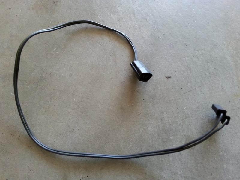

Just in case anyone is interested, some more research on the whole headlamp on buzzer. Now, this was part of the accessory light group option, maybe A01, but not sure, that it would seem most 73's didn't come with and was also available on 74's as well, and various models. I believe it included, key light, map light, glove box light, and of course the headlamp on buzzer. I'm not sure if part of this option were the fender turn signal indicators, but I digress.
Anyway, I managed to find the headlamp on harness on an old 74 Charger still in a salvage yard here, as shown in the diagram from Nacho above. Installed it and my NOS buzzer, and it works great!
Some pictures of the harness and the part number, which is most likely a 74 number not a 73 number, just in case anyone was interested or curious!

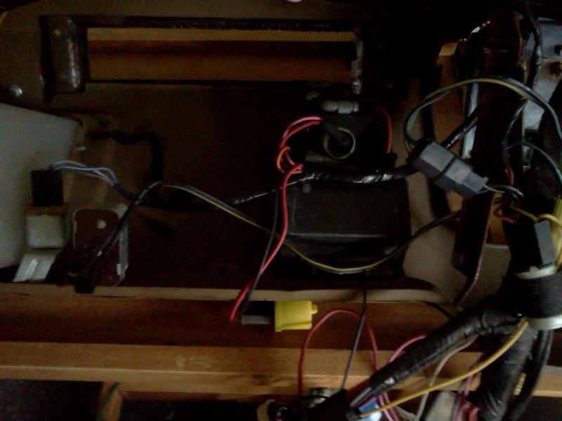

Well, looky what I seem to have.
Thanks again for turning me on to this.
This JY dash has paid for it's self twice already and I still have the radio, harness, frame and more to sell or use.

it can't be a 74 PN because 74s didn't got this harness nor buzzer ( not a B body at least ). The 74 Buzzer system was totally redesigned by 74, and uses just one buzzer for all the functions when full equipped ( key, lights and seatbelts )
great you got a harness!, However it could be home made ( I did it when my car was wired like a 71, like Venezuelan 74 Chargers did ). The only hard part to find could be the funky angled plug, but when I did it, got a damaged seat sensor switch found around and used the plug, which is the same.

Interesting, then it must be a 73 charger then, I'm not as familiar with Chargers, but junk yard said it was a 74, but if they didn't use that setup in them, it must have been an earlier model. Its not a home made harness for certain as the car it came from has the entire accessory light package. Either way, as you said, I'm just glad I got everything working. Its pretty funny when all three buzzers are going at the same time! Now I can drive people crazy with them! LOL

well, when I meant home made, is not talking about the one you got, but that you could made it at home ;) piece of cake ;)
Funny that you say that because I did make one, then I found the factory one. So I guess I have a spare now.
