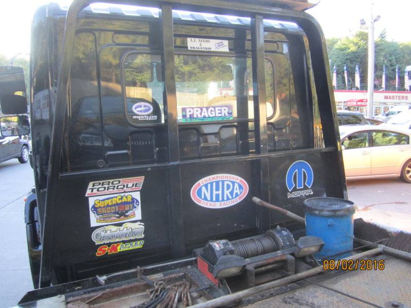

A magnet mount on the roof gets knocked over but is easy to just upright.That's why I was thinking of the whip........My headboard is stationary.

Thinking mounting the 2 whips on the light bar that attached to a fixed headboard.
