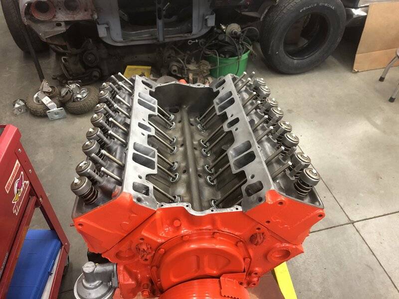

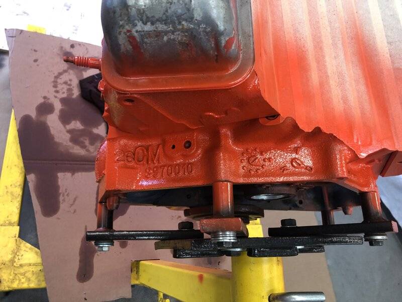

010 was cast all the way up to 79. Could be a 4 bolt or 2 bolt main. Could be a 350 or 302 possibly. The key will be the info stamped on the pad in front of the passenger side head. Take the alternator off and you will see it. You are looking for Z as mentioned earlier. Speaking of heads, look for two humps on them....camel humps. With or without accessory holes makes a difference in the casting of those. Mine are known as 370's and have acc holes for the alternator etc.
There are far more rare castings........010 is very common. But it can be something special too.

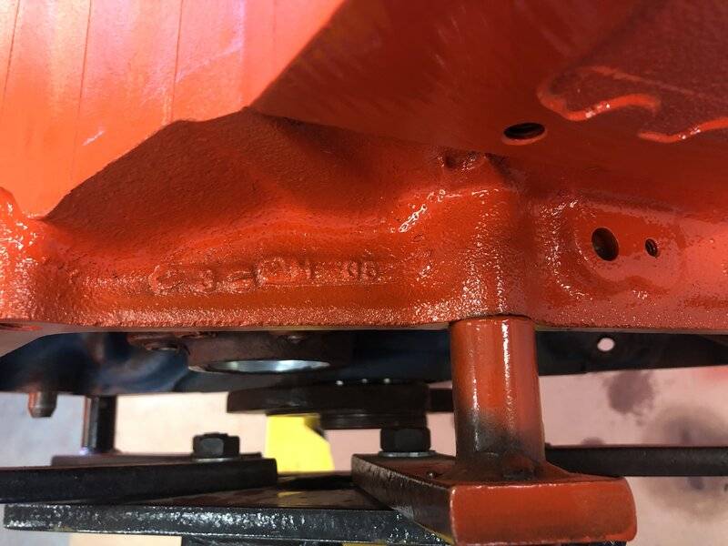

@Bb70charger500 - Check the cast date too, it’ll be number and a letter. That on the rear left side of the block, top of the bell housing where you found the 010 cast part #.

Wow ton of info about this and slot if interested people! I guess it is fairly rare I agree no hemi but rare enough I'll get it on a stand and see what numbers I can find worse case it's nothing fancy and it goes in the kids camaro to get abused best case it is very rare and is needed and I can swap it for something to put in kids car or sell it and find another motor locally.

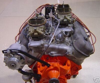

This is the rarest of the rare. 69 302 hemi Smokey Yunick
