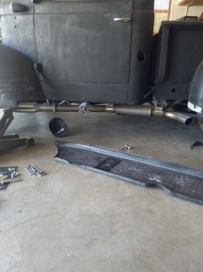

I have the Challenger T/A exhaust on my 71 Challenger convertible. I love cracking the pipes with the top down, you get the full effect of side exit exhaust! I have side pipes on the PERV Van too. PERV stands for Pete's Excellent Recreational Vehicle!
side pipes... it's a Chevy thing.
Not when you ain't got no choice. LOL.
Had to run mine out the side.
