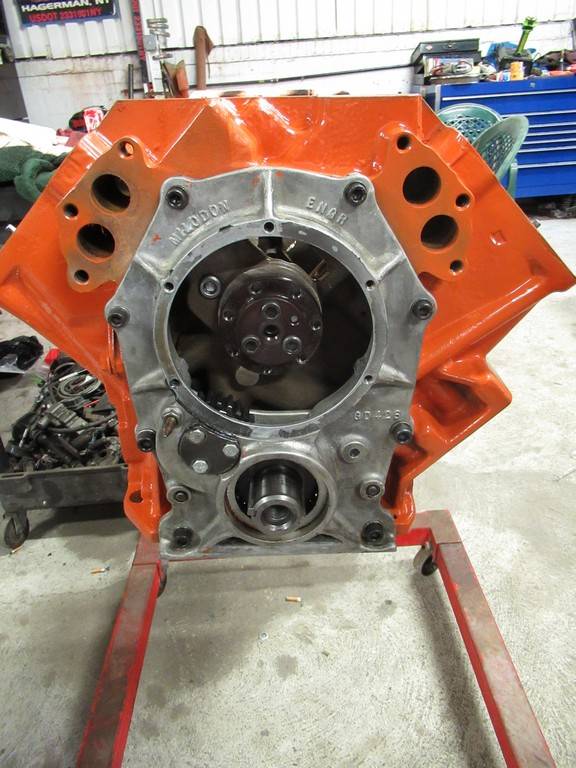

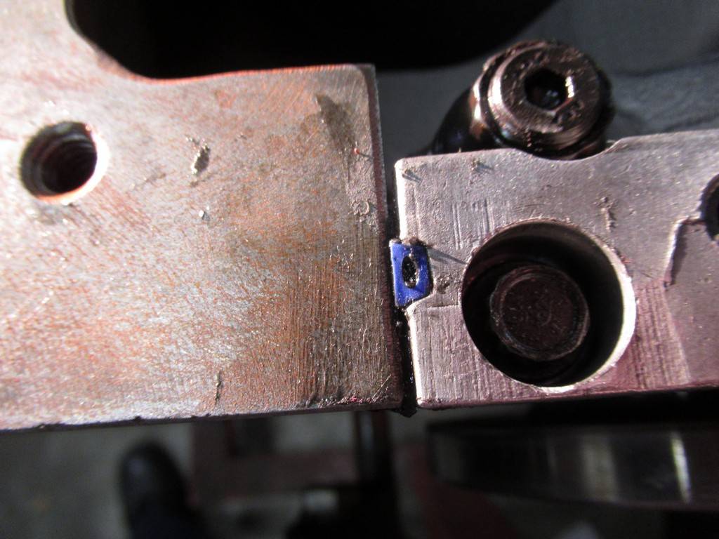

1st step is to pinpoint the leak. Low pressure air applied to the PCV hose at the valve cover with the breathers plugged. The oil will escape at the leak point. So let's say it is the rear main. Make sure the retainer isnt cracked at the bottom of the 2 oil pan bolt holes. If so install studs with sealer. The orange seals and stock cap work fine. Place the cap up in the block with seal installed and no side seals. Now install the bolts. Did it pull the cap sideways? If so the holes in the cap need to be opened up 1 drill size and rechecked until it doesn't move. Now is the gap on the sides of the cap the same? Probably not. This is why I use RTV only in the side grooves. When the retainer fits properly it can be installed. Use a slight bead (1/32") of anerobic sealer on the retainer to block. The final step is to fill the retainer bolts with RTV. Many times the pan doesn't cover these areas. My motors do not even seep.
