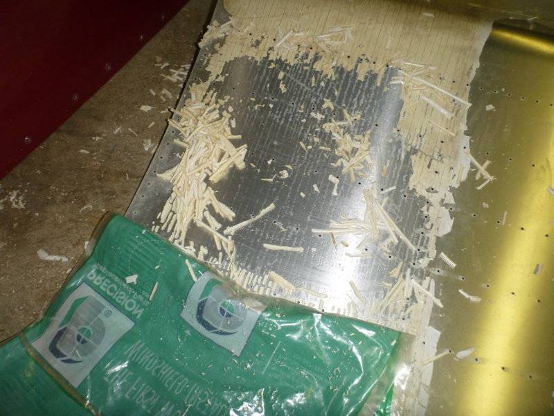

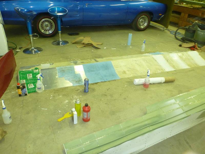

Try some naptha and see if it lets it go at all. I had 30 year old plastic protection sheet on some $$$ aluminum a month back that nothing would help release. Naptha (Coleman camp fuel) wiped on and then covered up with plastic for a few hours got it to dry out and let go.

View attachment 908525 View attachment 908526
Thanks Wayne,, I’ll give that a try. Really don’t wanna use a razor on this stuff. This is like forever glue, lol
Hey no guarantee it will work on the glue.. but it was the only thing I had in the shop that got old UV'd/bonded on protection sheet off aluminum without a lot of work or damage.
Oh I know. Can’t hurt to try it. Appreciate it
