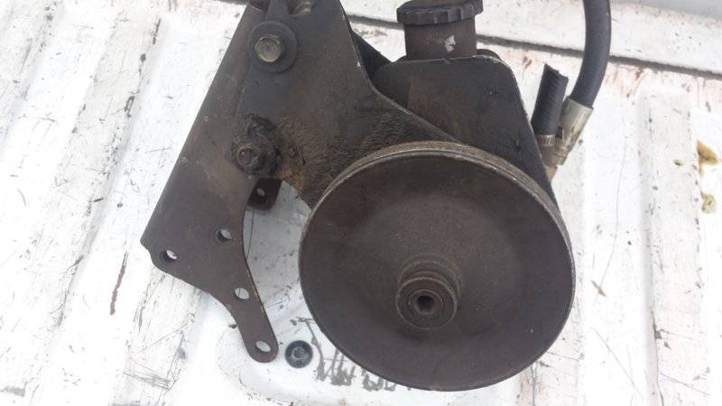

I vaguely remember removing the pulley from a Saginaw pump on a '75 Cordoba with a 360. It was a press on pulley. This was in the mid '90s.
I think you use the same procedure for anything that is press on. Use a puller to remove, and probably a bolt and washer(s) to install.

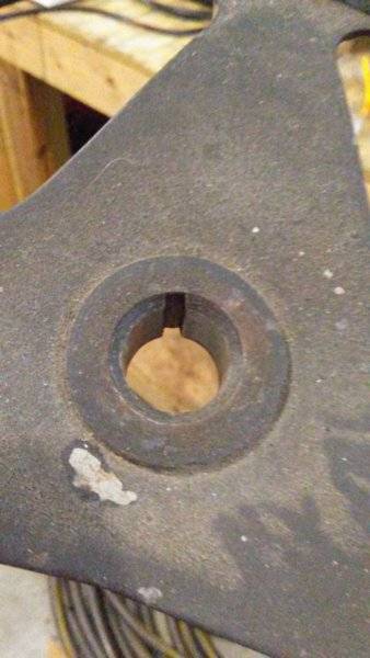

Pre 72’ Saginaw pumps had a threaded shaft with key way and nut. There is an early and late style Saginaw if it looks like a GM pump it’s the later one if it has
and round tank and oval neck it’s the early one.
Correct there are 2 different styles of Saginaw pumps.
The type that should be on the OP's 72 will have the 3 spoke pulley with the nut.
The later style has a solid pulley.

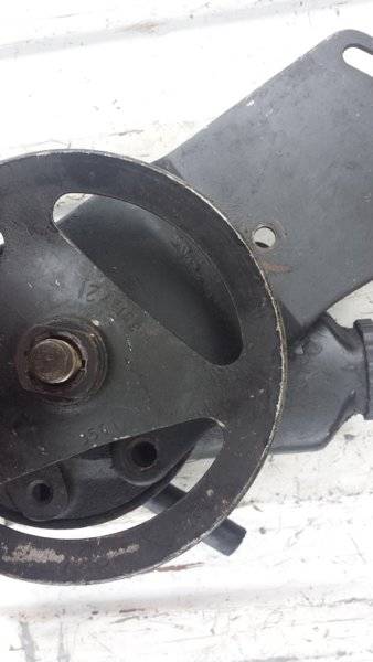

This one is from a mid 70's 440 truck. This one has the Delco reservoir but I've had them with the Chylser reservoir too.
Also I think the change was in 74. I've had a few 73's with the 3 spoke pulley and my 74's have the solid pulley.
And also again I've never had to use a puller on a 3 spoke pulley. Loosen but do not remove the nut. Then hold the pump pulley up with one hand under the pulley. Then a little tap on the nut and the pulley pops loose. Probably have changed 30-40 of them over the years.
