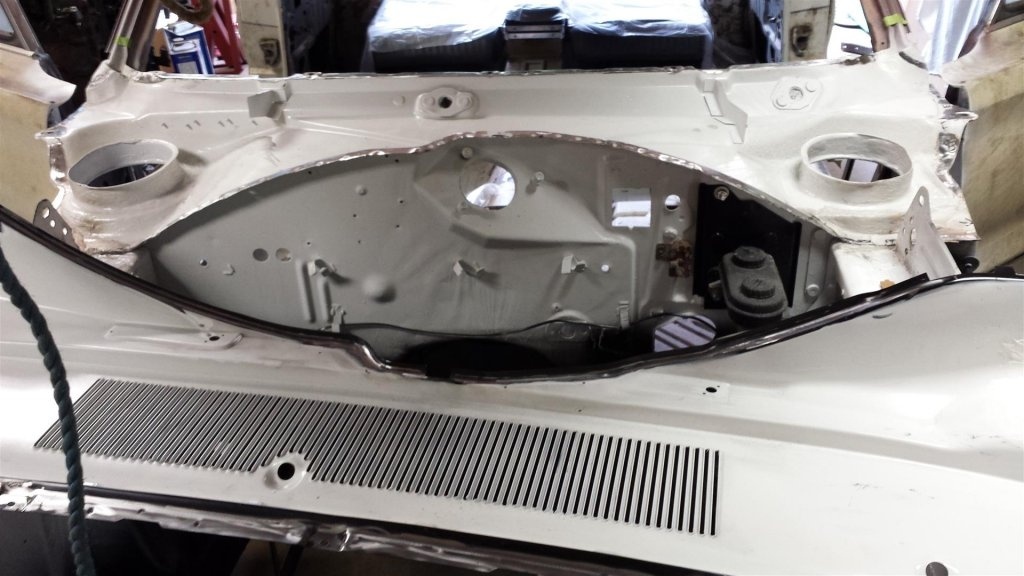

I know, but it's the rust repair in the window channel that's holding me back on paying someone else. I don't want to drop a grand & lose a month in a body shop. Safe-Lite is convenient, but they don't do rust repairs. If I get in a pickle, I will call in the professionals.
