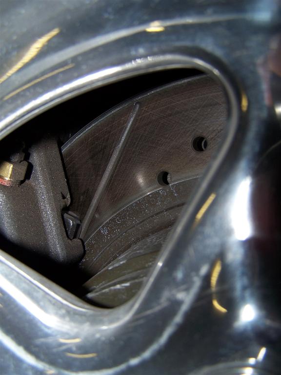

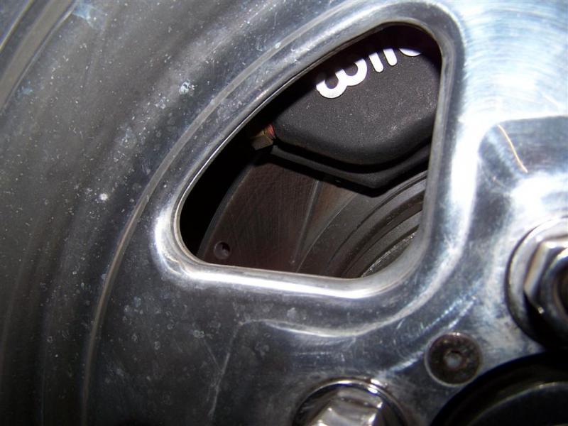

      rear mounted calipers on this car...

      Them brakes look nice Jeremiah, do they stop good?

          They work really well compared to the manual 11.75 pin-type caliper deal on our other charger. I did use a 15/16" bore master on the white-ish Charger to make sure the brakes were not overly sensitive during winter driving.
          The setup in the photo's are from my red car and it is a little different animal because it has 3.5" front wheels. I did put some 17" stickies on it for a day and "tested" my new suspension setup and it really impressed me. It still does not hold a candle to our SRT8 300C with giant power assisted Brembo calipers on all four wheels but for an old car it is worth the upgrade for the weight savings alone.
