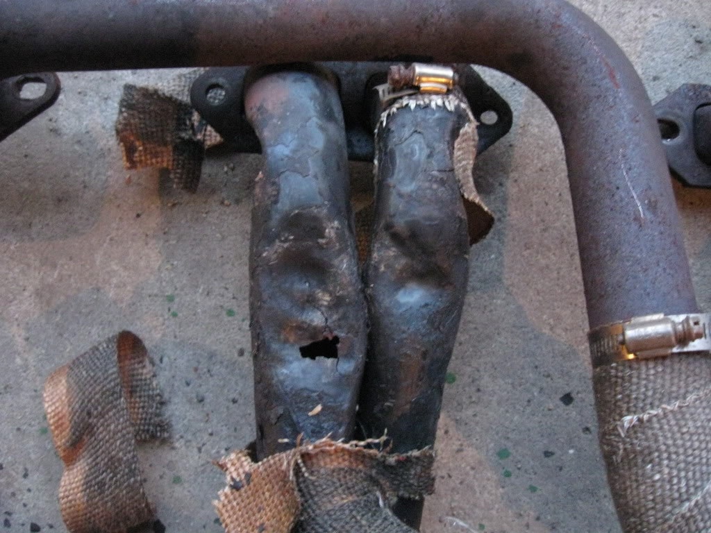

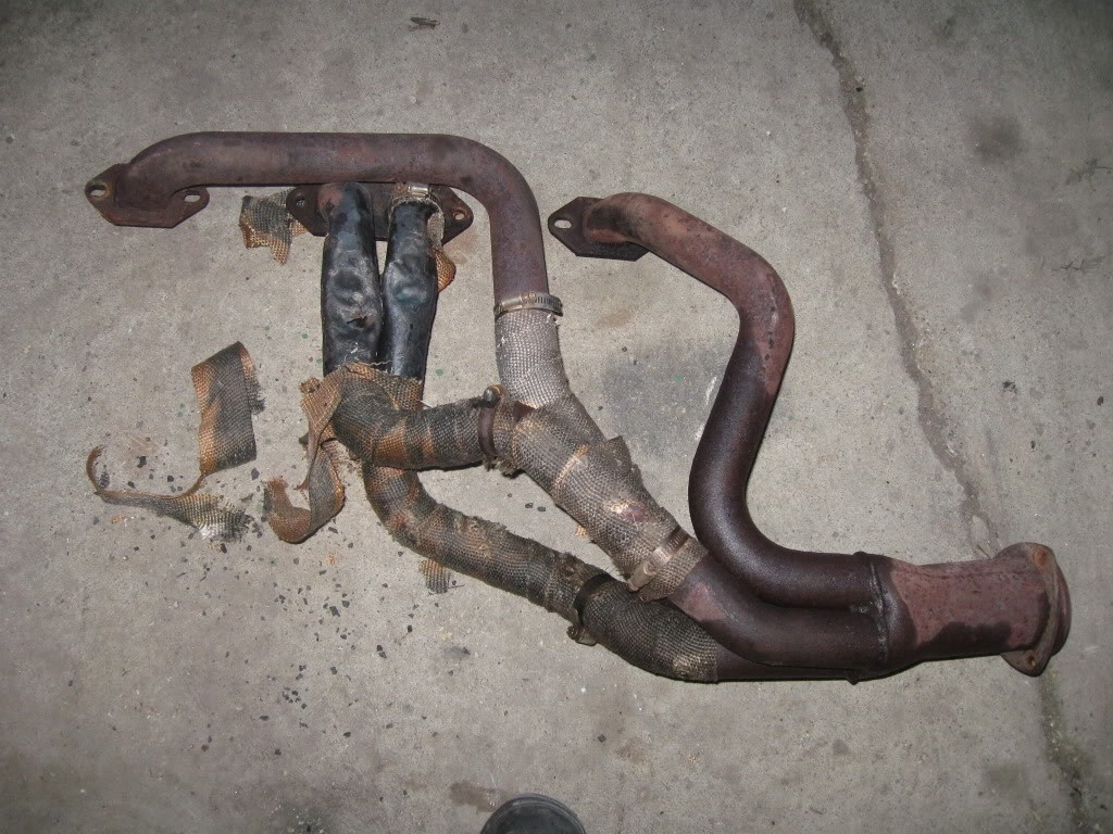

Here is the header that I took off my car. Everywhere the wrap was the tube was shot, crumbled like egg shells. Rest of the header was fine. Granted they were probably 20 years old. If they weren't wrapped they'd still be on the car.
New headers have been on for about 8 years without wrap. Starter is still cranking away. It's the same starter that was installed the same time the first set headers were bolted on...20+ years ago.
