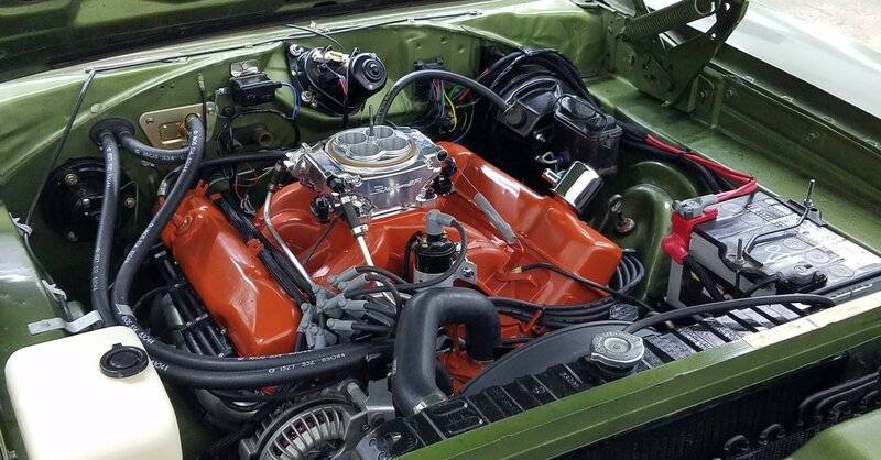

I had an issue with the ignition coil mounted in the original location on an Edelbrock RPM intake manifold on a 505ci stroker engine. The coil was too close to the front of the throttle body / ECU causing interference. I moved it away using the Mancini relocation bracket and fixed the problem. See photo.
I've installed a few of these systems and highly suggest using a simple relay to get a clean 12v signal while in crank and run positions. The first install I did worked okay without the relay but the next one would hardly run and was fixed by installing a relay. It all depends on the condition of your ignition switch, etc. Now I'll never install another one without using a relay.

Coil location could definitely be an issue too, like 69GTX mentioned. I've always had my coil over on the passenger side firewall, so nowhere close to the ECU on the sniper or the distributor wiring.

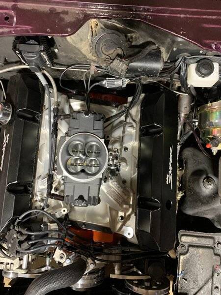

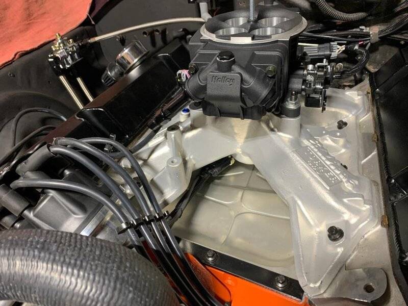

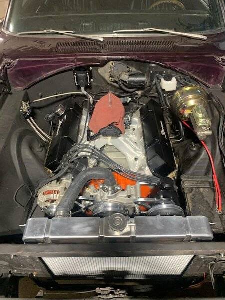

I also had no issues with any RIF in mine. though in the installation i made double sure to run things away from any source of problem.
