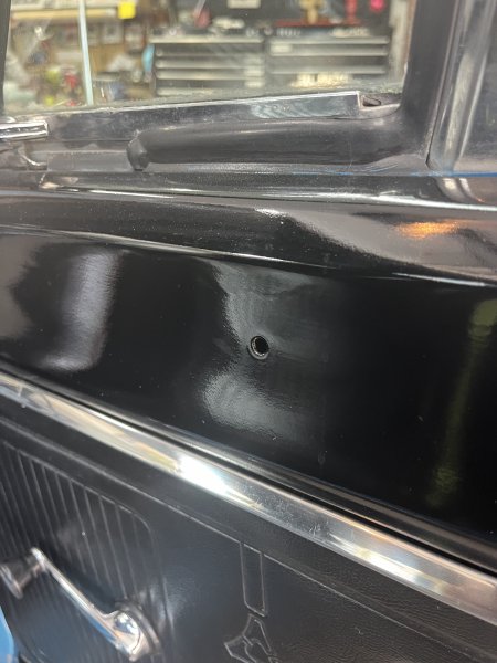

Anyone know what this hole is for

69 Coronet Super Bee….
Is there an adjustment screw in there? If so, what is it for?
It an adjustment to tilt the window in or out. I think. I’ll look at mine and report back.

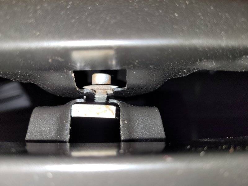

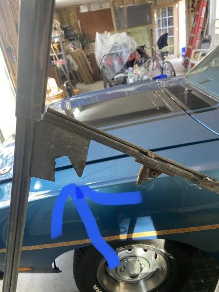

No, it's an access hole for the allen socket head screw and nut "block" that locks the vent frame between the front and rear door panels.

It holds the window assembly in place. No adjustments. My bad. You have to loosen it to remove the assembly.
You loosen that Allen and other fasteners to adjust the wing frame in the door.
Thanks guys… I tightened it up, no more rattles.
