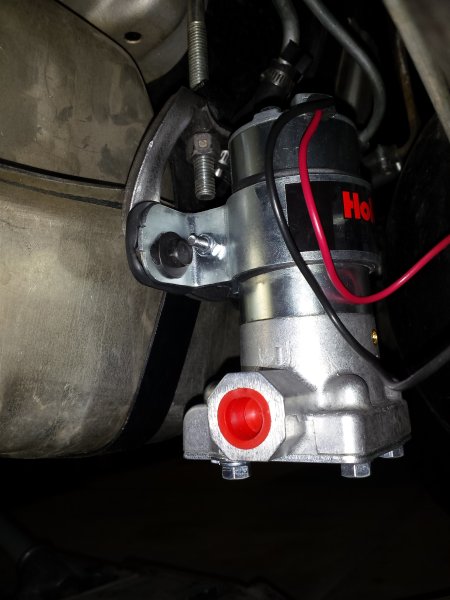

This is my pump/filter for a carb on a 62 Dart, looking straight up. It is not as close as the pic indicates, but it is a tight fit.

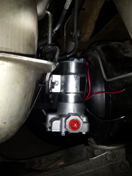

Kinda depends on the pump, etc. But I put mine on the inside of the frame, passenger side, just forward of the axel hump - just where it starts to become level. Keeps it low and (in my case) orients the pump correctly. Highly recommend using isolators in the mount.

Tough to see but I put it in front of the passenger rear tire between the frame rail and the rocker.

Is that above the lowest point of the tank?

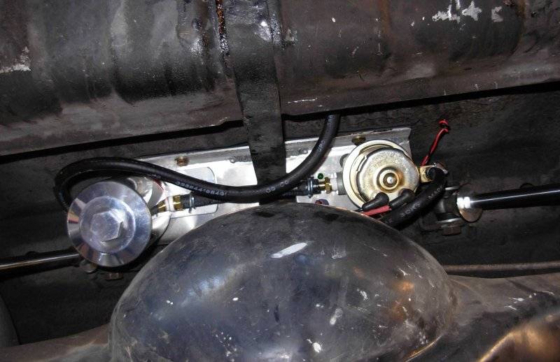

So are you saying your pump is higher than the lowest point of the tank?
Is that a Charger? Is that pump above the gas tank height?
Yes 66 Charger, it's probably 1" below the tank.

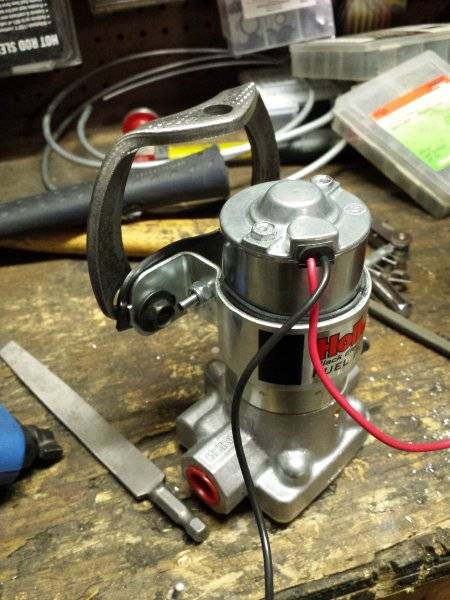

I mounted my old Holley pump on one of the fuel tank mounting bolts. Bent over a header collector flange.
it's level with the bottom of the tank
to be clear... the input is level if not slightly below the bottom of the tank.
