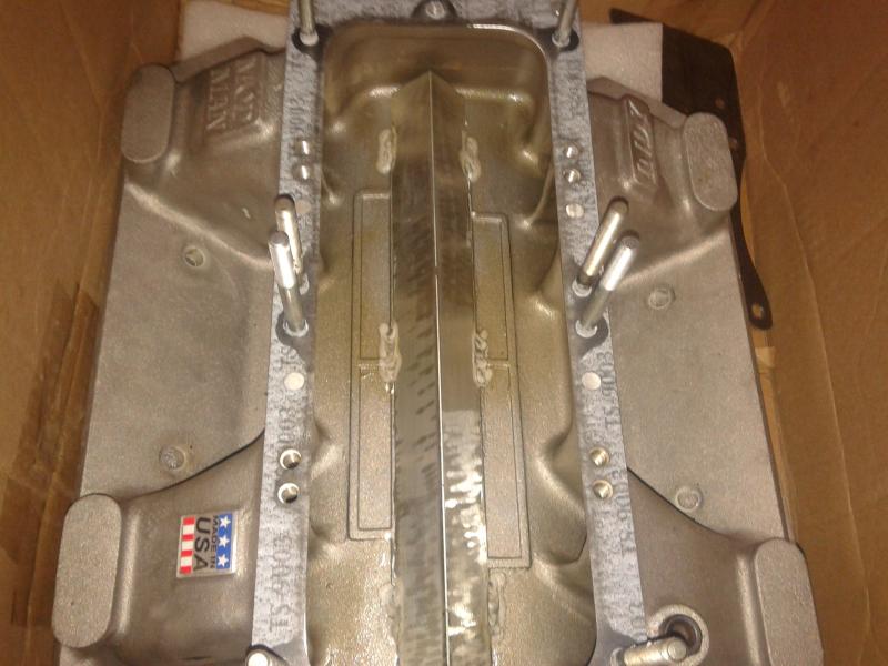

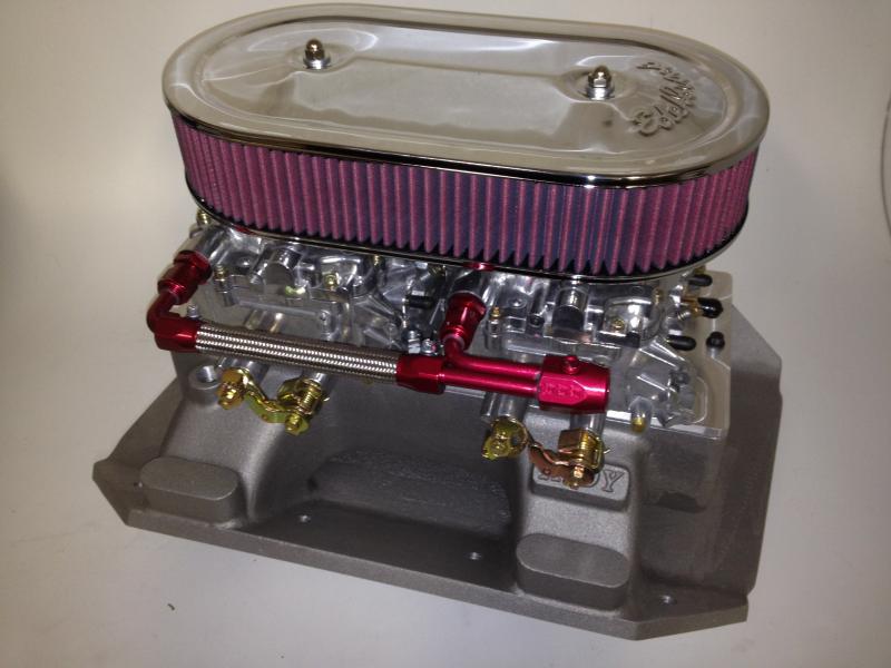

open plenum pic shows insert fitted
to sort jetting using graph don't worry about springs initially .
OK . Your primary jetting ( .83 jet/6552 rod ) shows at ref #11 which would indicate 2 stages leaner than stock calibration on cruise mode . Stock setting is 0.086 jet with 6552 rod , so I would put the 0.086 jet back in to start with in both carbs , this will richen up cruise and should reduce or remove surge .
0.096 is 1/1000 bigger than stock in secondaries , leave it for the moment . Get your cruise right first .
Once cruise is right then you will need to adjust rear jetting if required .
The reference chart is for primary only , OOTB calibration is #1 . Move around the chart up , richer , or down , leaner when setting cruise . Move left , leaner , or right richer for power . This is when you lean on throttle off cruise going to pass or going up a hill not total full throttle

View attachment 128839View attachment 128840
Tex
