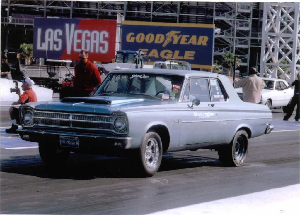

Real world.... I went from a dual plane M1 on a 451 stroker to a single plane Edelbrock Torker 383. Car went from a 12.30 to a 11.90

It was 11 years ago(sold the car) MPH was 110+-. Car weight 3600+200 for me.Cam was a prototype from Comp that soon became the Thumper.Lift was 490,[email protected] 236* LS 108*HYD.Don't remember the 60'.Found a note in it's file with the cam spec.
