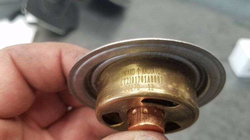

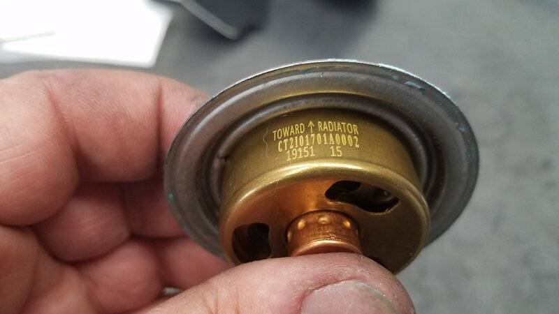

Doing a coolant flush on the Hemi. Pulled out a 160 stat. My guess is it is 15 years old. It has USA stamped on it. I am thinking about putting it right back in.
I always used Stant Stats with no issues. I have read that they are now Motorad, and junk.

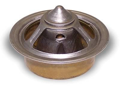

Milodon and EMP are the same unit, made in USA by RobertShaw. Best you can buy.
Milodon
EMP Stewart

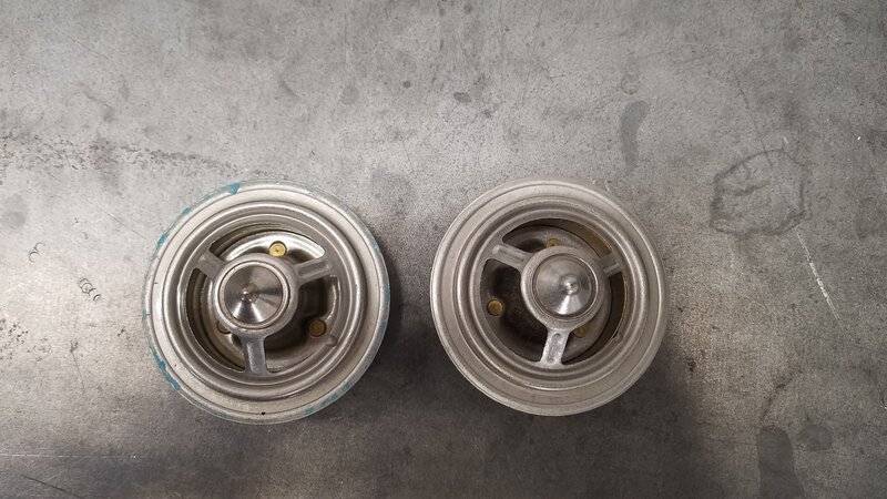

The stat shown in post #6.......is sold by Milodon, Shaw, Mr. Gasket & probably others....& made in the same Chinese factory.
[1] The three leg top piece is s/steel. The earlier ones that were made in the US had this section made out of brass.
[2] The drilled hole in the side are only needed if the w/pump bypass is blocked off. The original idea for these drilled stats comes from Stewart water pumps because their race pumps eliminated the bypass & the these holes were needed to bypass pressure build up, should the stat jam shut.
Unless you have blocked the bypass in your engine, drilling the holes is a backwards move because the engine takes longer to warm up & your engine will wear quicker.
[3] The Chinese stats often jam first time used because the internal rubber seal is tight. Dribble some auto trans fluid into the stat for lubrication & then test that it opens in hot water. I have found that after doing this they work reliably.
[4] Temp regulation is not great. They seem to open correctly, but a 160 once opened may not fully close until it gets down to 140ish.
