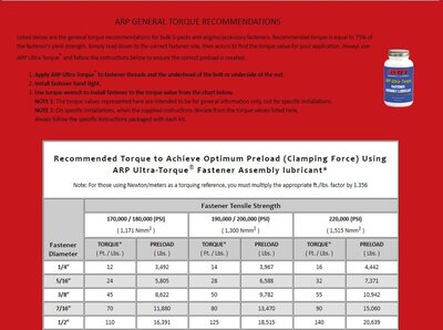

I am using ARP Flex Plate Bolts, Torque Converter Bolts and Bell Housing Bolts for my 440/727.
The only torque value I found from ARP was for the Flexplate Bolts (7/16") - 75 ft-lbs using their assy lube.
For the other bolts they simply refer you to a spec sheet, which requires you to know the tensile strength of the fastener (which I did not see on the website).
Anyone know the correct torque specs for the ARP TC bolts (7/16) and the bell housing bolts (7/16 & 3/8)?
8740 Chrome Moly: Until the development of today’s modern alloys, chrome moly was popularly considered a high strength material. Now viewed as only moderate strength, 8740 chrome moly is seen as a good tough steel, with adequate fatigue properties for most racing applications, but only if the threads are rolled after heat-treatment, as is the standard ARP production practice. Typically, chrome moly is classified as a quench and temper steel, that can be heat-treated to deliver tensile strengths between 180,000 and 210,000 psi.
ARP2000®: ARP2000 is an alloy steel that can be safely heat treated to a higher level, producing a greater strength material than 8740. While 8740 and ARP2000 share similar characteristics – ARP2000 is capable of achieving a clamp load at 220,000 psi. ARP2000 is used widely in short track and drag racing as an up-grade from 8740 chrome moly in both steel and aluminum rods. Stress corrosion and hydrogen embrittlement are typically not a problem, providing care is taken during installation.
I would say that your bolts are 8740 material unless they say ARP2000 on the head. I would use the 190K-200K column and torque to 50 Ft/lb for 3/8" and 80 Ft/lb for 7/16". The Flexplate kit 200-2903 instructions say to torque to 75 Ft/lb. ALL of these torques are with the ARP Moly Assy Lube. When you look up the part, there is a clickable button that says "Kit Instructions" to see them.
If you don't feel comfortable with these numbers, you can call them and ask for tech to get their recommendations.
