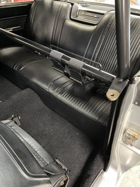

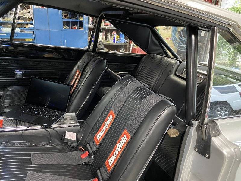

Low back seat and no padding
Honestly, the car is much faster than 10.0 more like low nines, possible high 8’s but I don’t have time to add halo or dash down bars before drag week. I will be slowing it down by pulling timing (Holley hp)
It makes over 850hp
High 8's in a Sat I'd love to watch run. If you've got the money in it to make it do that no point skimping now.
Just a tip on roll bar padding. Just because your helmet doesn’t touch the bar isn’t a good reason to not add padding. If you were to crash your body stretches a lot. I once was involved in a minor crash in an oval track car. Durring the crash I somehow was able to bend the rod that held the window net even though at rest, belted in and stretching I was 4” away from that net. We couldn’t believe on how far my body stretched in order to hit that net.
