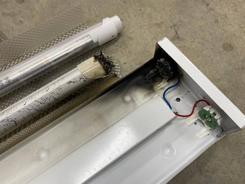

My plan today was to scrape undercoating off my Charger that's on the lift. The high bay lights are on a separate circuit then the main area with 12 T8 fixtures with LED bulbs designed for them. Well today when I flipped the lights on I heard a crackling sound and I looked up and one of the fixtures was glowing orange on one corner with sparks flying. Quickly killed the lights then the breaker.
Has anyone seen an LED tube melt down like this? I have 24 of these in the shop and no issues for 4 years since I installed them. When I pulled the light the wiring connections were tight and no other issues other then the tube melting down. With 24 of these I m afraid to even leave the shop with the lights on. It could have happened when I was mowing the lawn or something.

I checked every other fixture after and they all look good. Looks like it was festering for a bit. The tube is melted to the deflector.

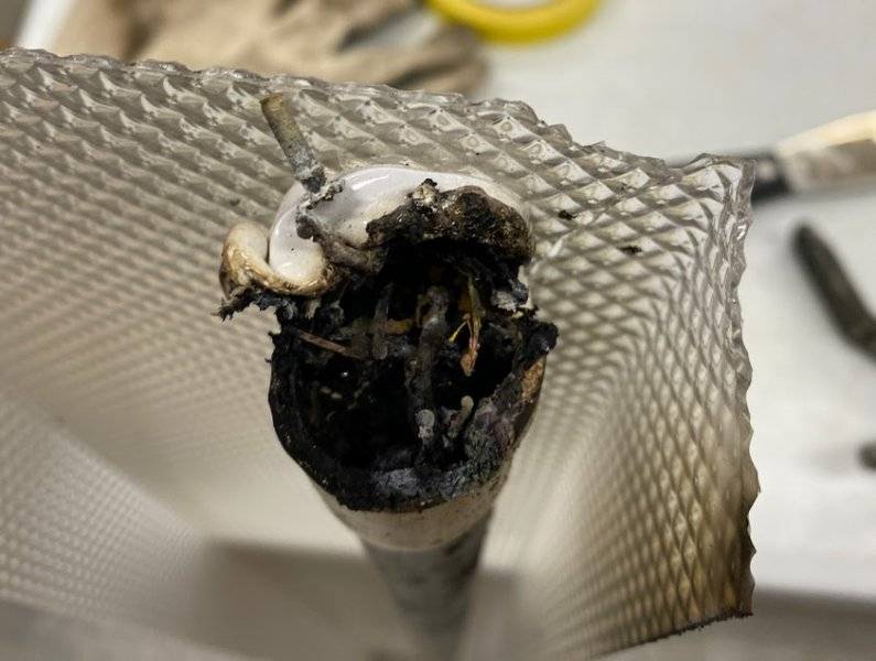

This is what the end of the tube looks like.
This would make anyone paranoid. I wired up a bunch of LED lights using quick-connectors, like those over wire nuts, what a light fixture mfg I worked with gave me. Only quick thoughts would be a defective light, socket was cracked, or that blue wire was assembled poorly. I might go around each fixture with a digi thermometer to detect any that are oddly warmer. Open that one up and inspect the socket and wiring, not sure; but it might give me some peace of mind.

It's probably the ballast. Happened to me in my garage. I got lucky also. Mine was only 1 month old. Took it back to Home Dumbo and they let me exchange for another. Found out from a friend that works there said they have been seeing this issue more and more. They also think it's the ballast on the units. You would think they would look into this? Naw, just keep selling the product. Glad your garage is ok.

Viewing your photo of the light, could have been a mfg defect that QC missed. The company I did work for had a test of every light and every so often, one was bad, wired wrong, or other component failure. They didn't make the lights, but they'd run across one that was bad.

Where the bulbs twisted all the way in? I've seen where if they are not secure or the socket flexes one of the ends will arc in the socket.
