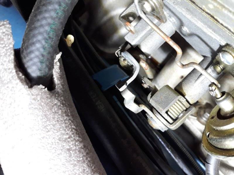

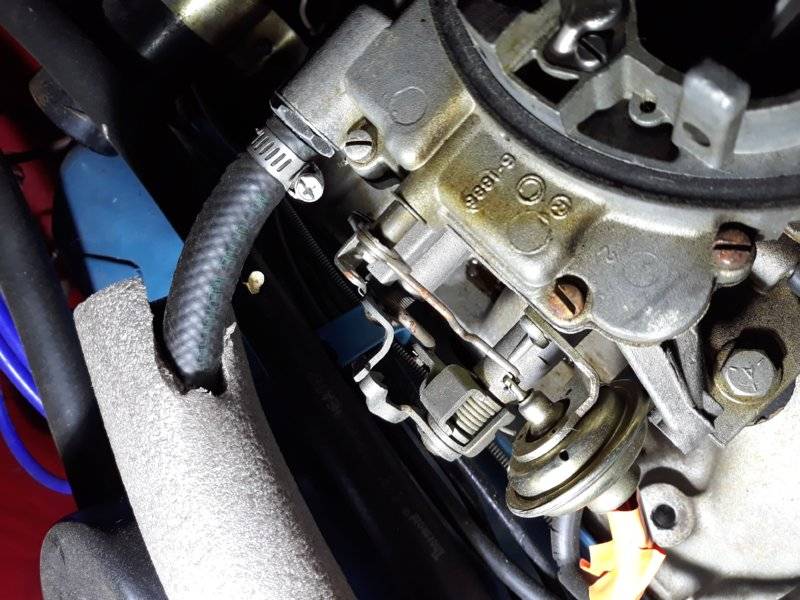

there should be a spring in the accelerator pump well. if it's not there then you can have the issue your having. there also should be a light spring wrapped around the exposed portion of the primary throttle shaft on the choke side. that may not be properly indexed.
Passenger side.
I got to looking at the coil spring on the passenger side and it should have no effect on what your doing. I did notice looking thru my spare parts 3 types of accelerator pump well springs and a 2 different lengths of pumps.
