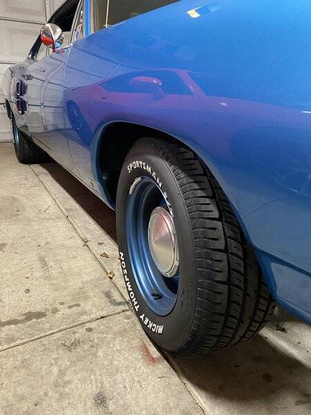

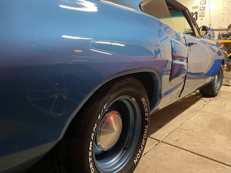

Wonder if they'll fit under the dog dish caps...
The dog dish caps fit with the longer studs.
*not sure I like the caps on there with the wide wheels. It’s like wearing a suit when you have a mullet.
